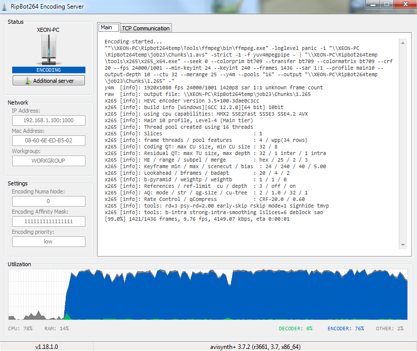

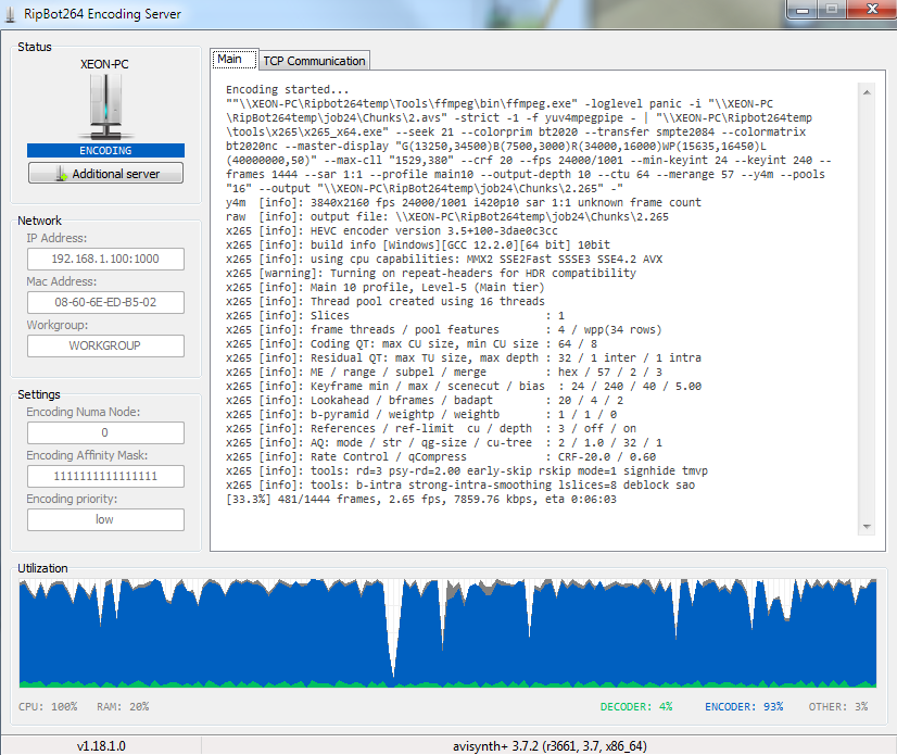

source AVC blu-ray 1080p (no avisynth filters!)
source HEVC HDR10 UHD 2160p (no avisynth filters!)
If you use software encoder x265 (with default medium preset) bottleneck is so huge that hardware decoding does not help.
Basically decoder most of time is sitting idle and waiting for requests from encoding process.
In my case decoding process was using less than 5% of CPU time.
I really do not care about that few percent and prefer much stable CPU decoding.
Atak_Snajpera is offline   Reply With Quote

That's why I asked if you did a REAL tests. Your claim that hardware decoding gives huge speed boost in encoding time is a lie.
If you do some filtering for example denoising/tonemapping in avisynth then you won't even get those 5% because even more time will be used by your cpu.
Hardware decoding is a placebo effect in this case. Deal with it.
