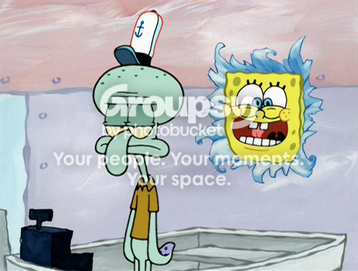

Here is before:
Here is after:
Now I think it does ok at getting rid of the halos outside of the characters however the ones around their eyes, Spongebob's teeth, and Squidward's brow lines never got completely removed and are still distracting when blown up. It did blur the source a bit and dilute the solidness of the outlines, which is to expected, but enabling the sharpening aspect of vmtoon reintroduced slight haloing and halved the encoding speed so I didn't opt for it.
So before I encode 100+ episodes using this script as the basis, I'd like to know if any pro Avisynth users here know of any way I can either make the script more efficient to make encoding faster (~4.5 fps encoding high-profile 4.1 x264 on 4 cores lol) or that can fix the halos while keeping the lines as dark as the source (like using better settings or similar filters). A lot of the black outlines (on the source) have speckles which make them look kinda dashed, for lack of a better explanation (see the bottom lines around Spongebob's eyes in the original pic) so I was hoping there was a line darkener or settings that could smooth those out too.
