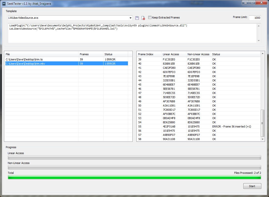

Is this all as expected?
I can confirm. Remuxing to mkv with mkvtoolnix solves nothing

I'd forgotten about Seek Tester! Definitely going to put that to some good use.
Does it seek forward and store a hash per frame, or something, and then seek randomly and test the hashes to see which frames are returned?
