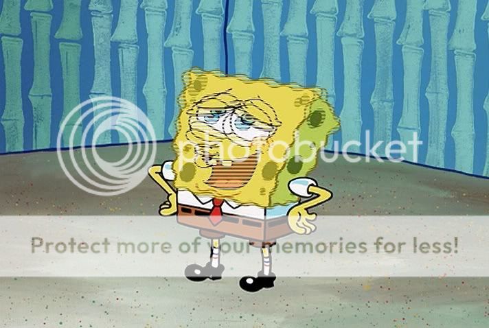

Hi! Not sure where to post this... I thought this was field blending but I'm not sure now as deblend filters do not affect it. It is like the frame has ghosting that anticipates the following frame, but only areas of high contrast like dark outlines. It doesn't happen all the time but it's a noticeable problem when the video is in motion so it bothers me a lot. I've tried using IVTC and/or filters like srestore and no solution. Any help is appreciated!

Here's the processed image with the unwanted result:

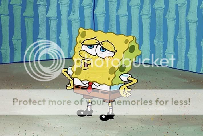

Here are the three frames that when inverse telecined with AnimeIVTC mode=1 result in the artifact.
Curious what the following frame look like?

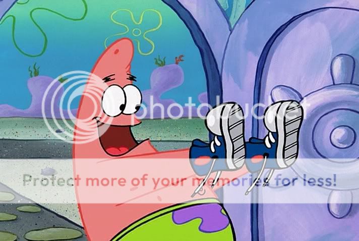

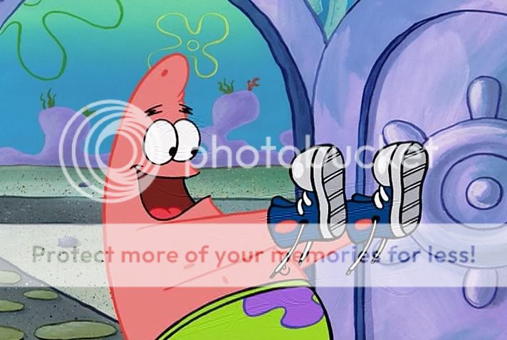

Edit: Well it's not actually AnimeIVTC doing it in every example. Below is a series of 3 untouched frames where that weird artifact shows up even before inverse telecine is applied:
Look at Patrick's face and how the lines are actually lines from the following frame and in the next one the lines are from the previous frame!
