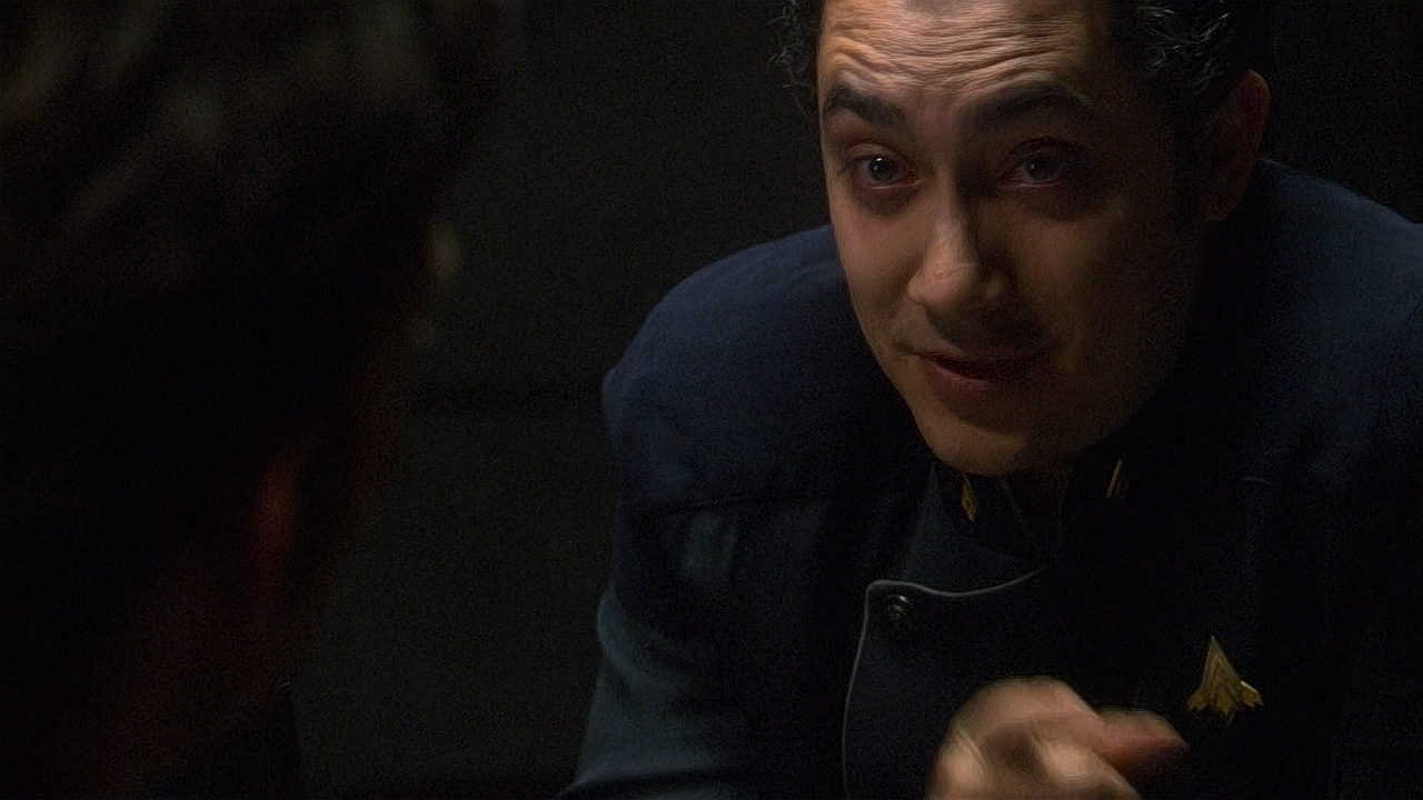

@Dogway, I've been experimenting ex_Vibrance(), to be more precise the Recovery mode to get back the proper saturation after rainbow removal.
The issue is that ex_Vibrance is working okish, i.e., it does recover contrast in areas that where lost, but the problem is that it is also getting back the rainbows in some places.
There also frames where the issue is even worse than before (see below)
Any idea why? I mean, any idea if this can be avoided?
This idea of getting back the contrast after removing the rainbows is a neat idea and it would be awesome to be able to make use of it.
Here is an example.
Source: (Rainbow is visible in the centre near the hole, near the vertical lines etc)
Source + Scomb: Rainbows are gone
Source + Scomb + ex_Vibrance: Rainbow is back and vertical lines are now surrounded by a Yellowish "aura", i.e., rainbow effect is accentuated
Script used:
DGSource("ep1.dgi")
vibrance=last
scomb()
ex_vibrance(1.0, mode="Recover", Rc=vibrance)
PS: Yes, the video is interlaced, that's where scomb really shines. Probably that's the issue... oh well
PS2: I made the same test but with progressive video and the issue remains exactly the same

@fabioseixal: I think in this case it's better to increase saturation or vibrance. If your filtering is local then the difference of saturation in "recovery" mode is also going to be local. "Recover" works better with mostly global desaturation like denoisers and such.
For DeRainbow I used to use:
edgy=FlatMask(2.0).ex_expand()
ex_merge(last,FFT3DFilter( sigma=2, sigma2=8, sigma3=12, sigma4=4, bt=3, plane=3, ncpu=4),edgy.ex_expand(),Y=2,UV=3,luma=true)
but FFT3DFilter is slow so you can try other denoisers.
I also had this expanded version which kills rainbowing further and preserves saturation a bit better.
o = last
derain = o.ex_median("median",Y=2,UV=3)
Hmed   = ex_luts(o,o,mode="median",pixels="-2 0 -1 0 0 0 1 0 2 0",UV=2)
Hedge  = ex_lutxy(Hmed,o,"x y - abs 8 *",UV=128)
ex_merge(o,derain,Hedge.ex_expand(2),luma=true,Y=2,UV=3)
ex_merge(o,FFT3DFilter( sigma=2, sigma2=8, sigma3=12, sigma4=4, bt=3, plane=3, ncpu=4),edgy.ex_expand().ex_vibrance(1),Y=2,UV=3,luma=true)
