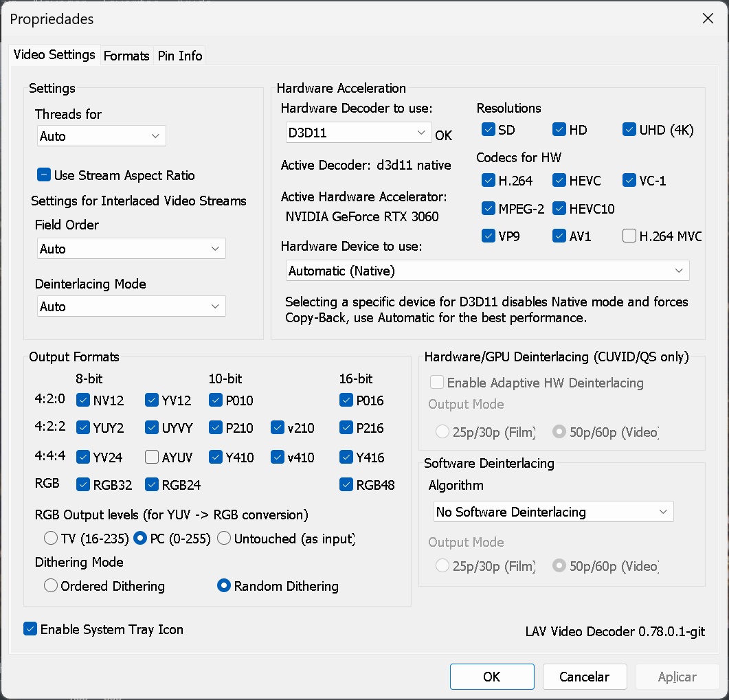

LAV: https://i.postimg.cc/z5fz3fRw/LAV.jpg
MPC Video Decoder: https://i.postimg.cc/YMGtfyRh/MPCV.jpg
Note: all internal filters (from MPC) were disabled.

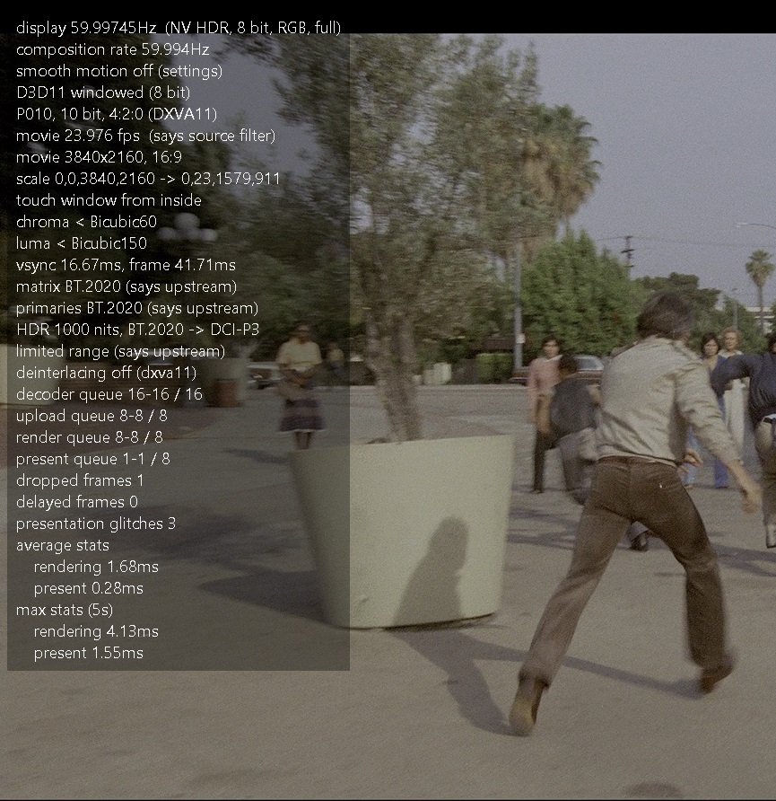

madVR stats:
https://i.postimg.cc/sy2TLktD/MADVR.jpg

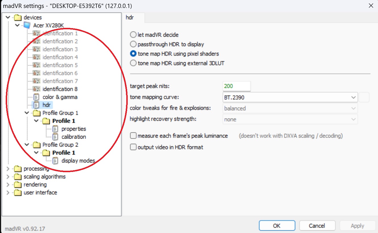

For some odd reason, all these inside the circle:
https://i.postimg.cc/gz4mLLJb/OPTIONS.jpg
Only appeared after I used the option "create profile group", then played a few videos (one of them a 4K/UHD MKV (movie) extracted from the original disc)... so what's the catch?
Do we need to play a few videos or wait for that option from the 1st screenshot magically appears? Because it wasn't in my first visit to madVR internal settings.
If these options are hidden and never appear when we need, we can't configure anything.

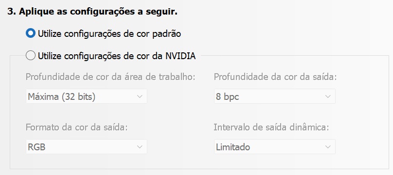

When I looked into NVidia's control panel (from the RTX 3060), it said
https://i.postimg.cc/mkgbhMJV/NVIDIA.jpg
Output Dynamic Range (LIMITED, not full)
And Output Color Depth = 8 bpc
