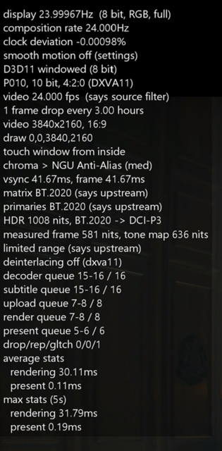

Old 26th January 2025, 20:21   #65624  |  Link
647830
Join Date: Dec 2024
Posts: 11
important frame repeats MPC-BE+MadVR
I have important frame drops and need advice from experts here.
My set-up is the following:
Windows 10 22H2 build 19045.5247
GPU NVidia GTX1080 (385.28), CPU i7-7700 3.6GHz, JVC DLA-RS46
MPC-BE 1.8.2, LAV Filter 0.78, MadVR 0.92.17, 113 beta
I am playing a 2160p 24Hz UHD with Dolby Atmos 7.1 sound track.
During the first 25 min or so all works well, my rendering timings look ok at c. 30ms.
Then suddenly the clock deviation increases, decoder queue changes, I have a lot of frame repeats, sound is distorded and clock deviation deviates a lot:
After a few minutes, it gets back to "normal".
I am wondering what to do, I have tried several things without success. Can it be that the filters applied are too demanding for my GPU? or should I consider looking at other things please?
Any help much appreciated and many thanks for your advice.
647830 is offline   Reply With Quote

clsid
Join Date: Feb 2005
Posts: 5,787
Win10 Settings > System > Display > Graphics Settings > disable on "Hardware-Accelerated GPU Scheduling"
If that does not help, then lower CPU queue size in madvr to 8.
If that does not help, then change the hardware decoder from D3D11 native to D3D11 copyback or DXVA2 copyback.
If that does not help, then set NVIDIA to high performance power mode and complain to NVIDIA.
MPC-HC 2.6.1
clsid is offline   Reply With Quote
Old 26th January 2025, 21:46   #65626  |  Link
647830
Join Date: Dec 2024
Posts: 11
Thank you clsid.
For the first one, I don't have this option in my win10 (maybe due to the NV driver I have which is old but supposed to work for HTPC?). I did lower the CPU queue to 8, not solving the issue. DXVA2 copyback no change either. My NV was already set at "high performance power mode".
I can complain to NV, but not sure it will move the needle. Any other idea please?
and, last question, is there a graphic card / GPU on earth which works well for HTPC with not issue, good sync to avoid CustomRes, etc. ??
Best

Old 27th January 2025, 13:06   #65631  |  Link
huhn
Join Date: Oct 2012
Posts: 8,623
your decoder queue or subtitle queue is the issue. check your CPU load or try a risky decoder like d3d11 native.
if it is the subtitles starving the decoder try the same part without subtitles.
Originally Posted by Nemo1985 View Post
Hello, I'm impressed that noone speak about the amd driver issues with madvr.
The latest driver I could use without issues were the 24.3, I updated the driver back in october (and kept doing so) still nowadays ED2 as dither method hangs up the application for half of a minute with mpc-hc.
I also tried the bet version of madvr but with no changes.
How is it possible that noone with radeon 6xxx video card has this issue?
Even changing the dither method to something else doesn't solve the problem, instead of hanging when a video is loaded it hangs after it's played.
Reference: https://github.com/clsid2/mpc-hc/issues/3223
I wonder, amd is notorious for their bugged video driver, madvr is not updated in ages, is there any solution to solve the issue?
the solution is not using ED2.
AMD had a copyback bug with openCL for the entire life time of the products series this is nothing in comparison.
hell nvidia had openCL bugs for many many years making it run so slow it was utterly unusable.
huhn is offline   Reply With Quote

Posts: 11
Thank you huhn, i have disables subtitles, tried another decoder but without success. It is indeed a decoder queue issue apparently but don't understand why. On some movies, no issue at all, on others it is awful. looks like it is happening on 4K 24Hz movies with Dolby Atmos only.
Any other recommendation? If not I will reset my PC and restart from scratch ... but have no backup.

huhn
Join Date: Oct 2012
Posts: 8,623
what hardware are you using?

647830
Join Date: Dec 2024
Posts: 11
GPU NVidia GTX1080 (385.28), CPU i7-7700 3.6GHz, JVC DLA-RS46 (X35)
