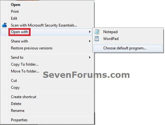

Posts: 176
Since changing the program version, folder, etc. VirtualDub doesn't want to show up in the "Open With" list (I mean the context menu, not the window with "more" applications).
I used to have VirtualDub there, then I changed the folder, new version etc. and since then it doesn't want to show up in this menu, even when I make it the default application for e.g. avs.
The only thing I've googled is that others also have this problem with VirtualDub.
How do I fix this?
rgr is offline   Reply With Quote
What you write is not a VirtualDub problem. It is an old Windows bug.
https://superuser.com/questions/9165...s-my-selection
