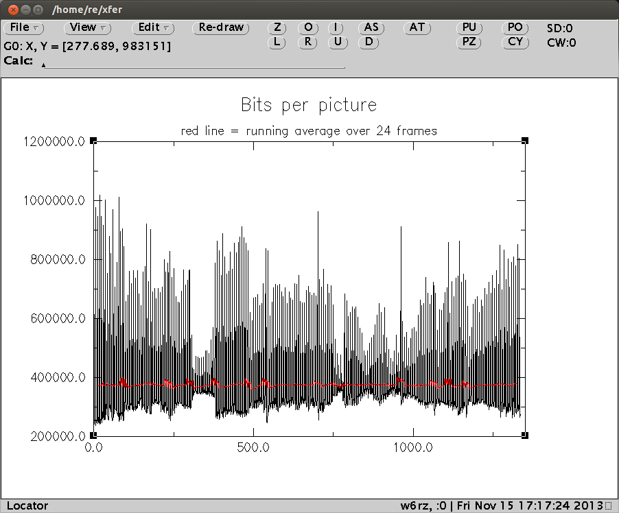

Old 16th November 2013, 02:34   #10  |  Link
drmpeg
Join Date: Jan 2003
Location: Silicon Valley
Posts: 455

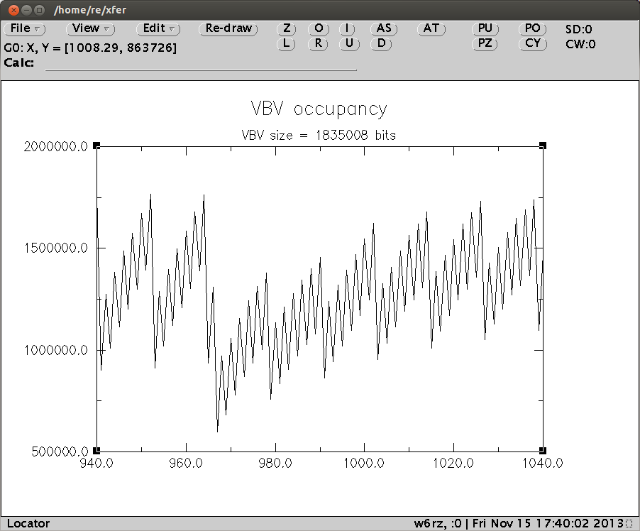

For analysis, it's very useful to graph things out. Here are some plots from an MPEG-2 encoder I used to work on. The bitstream is true CBR with an IPPPPP GOP. Looking at the running average, it can be seen that the CBR rate control is pretty "tight" (doesn't fluctuate much). The upward spikes are due to I-frame insertion at scene changes.
And a zoom in.
Ron
HD MPEG-2 Test Patterns http://www.w6rz.net
drmpeg is offline   Reply With Quote

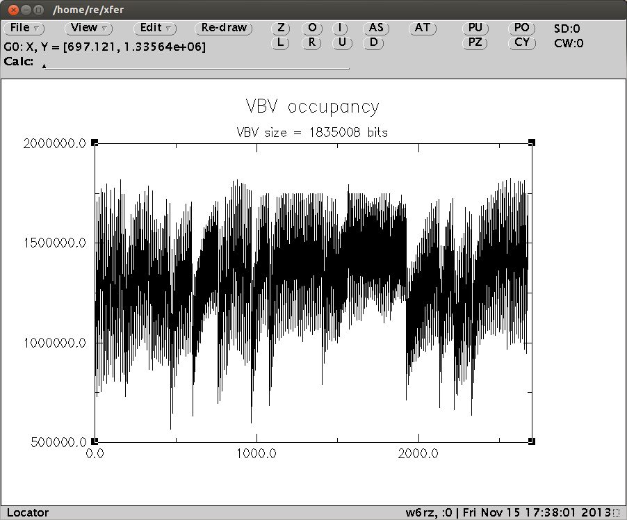

Old 16th November 2013, 02:44   #11  |  Link
drmpeg
Join Date: Jan 2003
Posts: 455
VBV graphs for the same bitstream.
And a zoom in.
Ron
