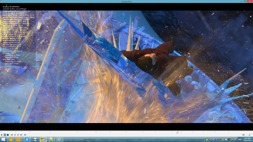

Running the chroma shaders in MPC-HC in pre-resize in order, the first two blur the image, and with the third one the image looks blown out and grainy. With the YbCbCr file, basically the same problem. Chroma set to NN.
Clearly not working here.
GTX 660, newest Madvr, nightly MPC-HC, Windows 8.1.1.
From the samples shown however, this looks like a great middle-ground between Chroma Jinc and NNEDI3, which for DVD and lower quality content I just cant combine with Luma NNEDI3 16N with both double and quad enabled on this 660 and i7 870.
Wish NNEDI3 ran on DirectCompute.

Old 12th June 2014, 15:11   #74  |  Link
Shiandow
Join Date: Dec 2013
Posts: 753
Could you post a few screenshots of what happens?
Shiandow is offline   Reply With Quote

Posts: 48
Nearest Neighbour
Chrome-NEDI
FireFreak111 is offline   Reply With Quote

FireFreak111
Join Date: Apr 2014
Posts: 48
Sorry for the full size images, photobuckets linking is messed when trying to use a full size image.
There is a distinct blur when using these shaders, it doesn't appear to be working correctly.
Nearest Neighbour:
Chroma-NEDI
Old 12th June 2014, 15:58   #79  |  Link
Shiandow
Join Date: Dec 2013
Posts: 753
Are you sure that the input is in YCbCr? Because it looks like the kind of images you get when the input is RGB.
Old 12th June 2014, 16:02   #80  |  Link
FireFreak111
Join Date: Apr 2014
Posts: 48
Thankyou, I had named the YCbCr file wrong. The YCbCr to RGB should be post Chroma-NEDI right? It seems to be working correctly now.
