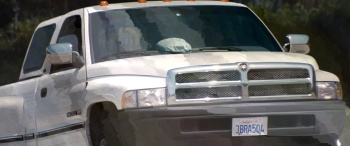

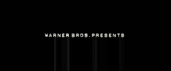

There is some sort of corruption visual glitches decoding x264 with LAVFilters-0.79.2-41 and LAVFilters-0.79.2-47. Last working version for me is LAVFilters-0.79.2-31.

Going to need a sample file. Also software or hardware decoding? I have no observed anything like that.

MPC-BE latest stable build, madvr 112, LAVFilters-0.79.2-47. Happens only with x264 with one movie: D3D11 Native in LAV video decoder. Sample: https://1cloudfile.com/N16v

Thanks for the sample, I can reproduce the issue. Will take a look.
Edit:
Fixed
