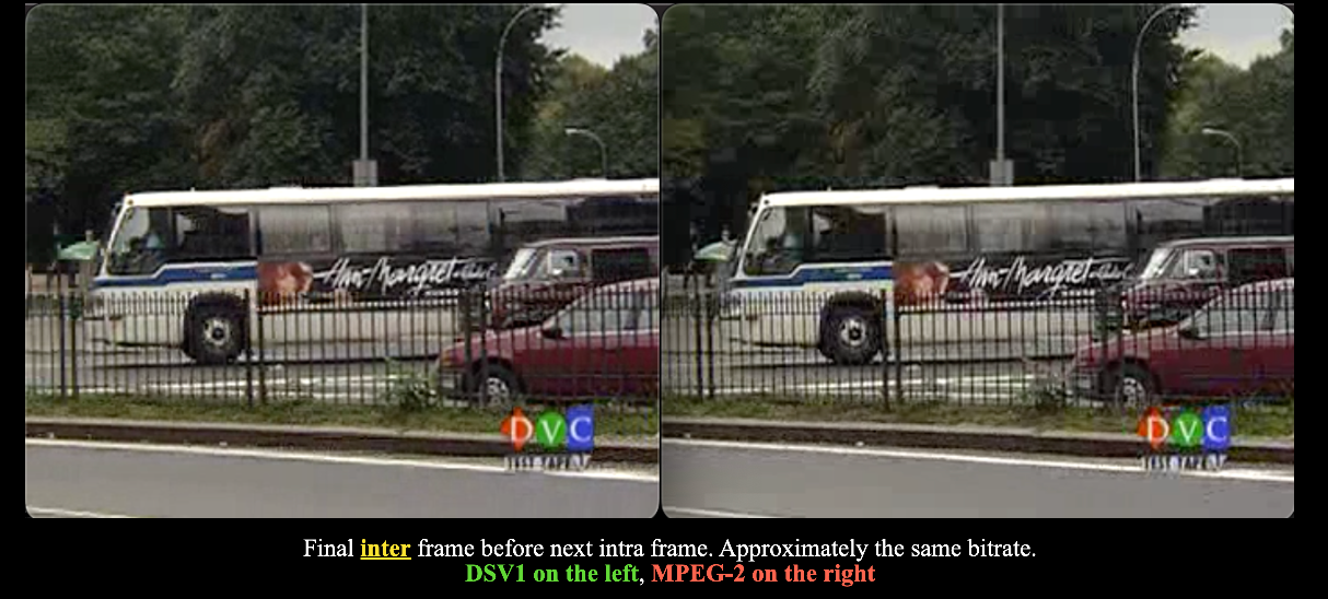

Hi Doom9, I recently developed this:
https://github.com/LMP88959/Digital-Subband-Video-1
DSV1 is comparable to MPEG-1 / MPEG-2 but uses wavelets instead of the DCT.
I intend to use it as a video codec for my game but I believe it might be of interest to some of you here

not sure i really need another video codec at this point, but i'm interested.
my superficial look is that DSV1 maintains a lot of detail at expense of blurring out other parts of the frame or worse.
Thank you!
