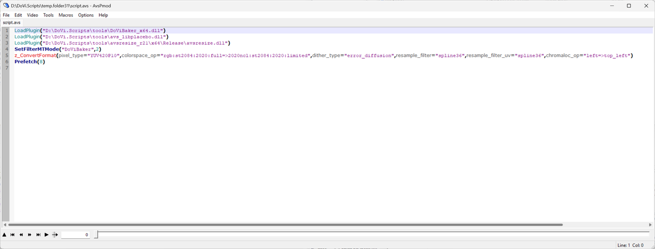

This is how the avs script looks in avspmod:

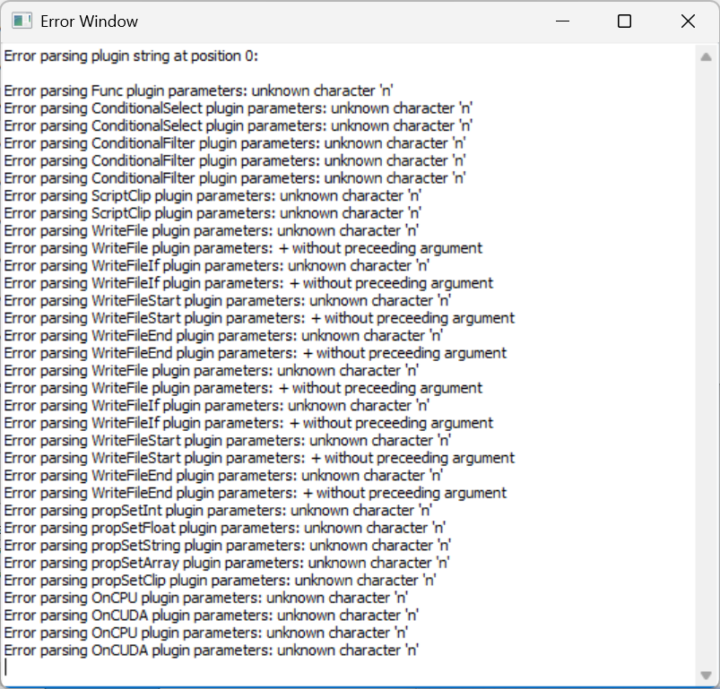

However, when I try to run avspmod, before loading the avs script whose screenshot I've shared above, it gives me this error message:

the script is incomplete, so it fails at indexing either with ffms2 or dgindex
did you install python? Watch the script installation tutorial.
