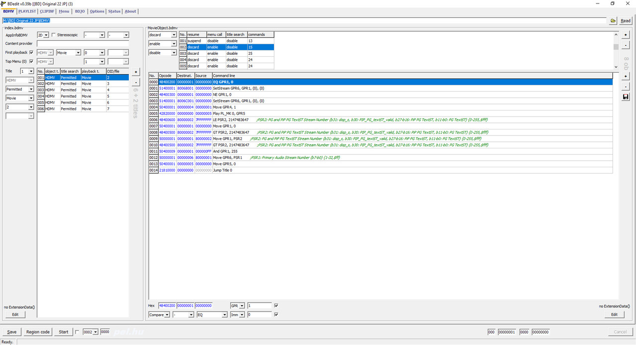

I'm having trouble changing the subtitles on this Blu-ray disc.
I'm replacing the subtitles on this Blu-ray with Spanish subtitles using Kite. Once the Blu-ray disc is mounted, I test it.
Everything looks perfect on my PC, but on my PS4, I can't start any chapter. I can select everything through the menu, but the chapter doesn't start. I should also mention that I modified the instructions, which were similar to this: `SetStreamGPR6,GPR1,(0),(0)`, because on the mounted Blu-ray disc, they appeared like this: `SetStreamGPR6,GPR11,0,0`.
The region protection is removed with anydvd 8.1.7.0
I've attached images of the original and the edited Blu-ray disc to see if you can help me.

Hi Lucho.
Your screenshot shows 00000.mpls, but what does it include?
If this is the disk menu, then it is unclear why so many m2ts are written in the third screenshot,
I see from 0 to 7 m2ts there, but in the same place in the SubPath tab it is indicated that IGMenu is located at 00030.m2ts.
Although the fourth screenshot shows 00000.clpi and there is no IGMenu in it.
It's hard to tell from the screenshots what's wrong, so send the disc without the movie so you can check it out.

Thanks for your reply, @Taurusus.
Just so you know, screenshots 1, 3, and 5 are from the original Blu-ray, while screenshots 2, 4, and 6 are from the modified version.
The mpls 00000 file contains the 13 episodes of the series, and the other 17 files are between mpls00001 and mpls0007.
I've included images of mpls00000 and playst 00001 so you can verify that there are no alterations to the records of either.
Here's a RAR file with the disc without streams, as you requested.
