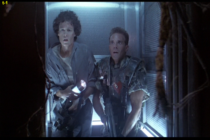

Here is an example of forward prediction . t+1 derived from t-1 and t0 - with a usable working demo
https://github.com/megvii-research/CVPR2023-DMVFN
(apngs, should animate in most browsers)
demo example - axial object rotation looks decently predicted
example on different data set
<edit> see post 11 below, added t+2 frame

Wow. Even the torn ropes/cables look convincing.

Maybe a few seconds . It's not as fast as mvtools2 , but not as slow in the order of something like ESRGAN
Another machine learning prediction project
https://github.com/YueWuHKUST/CVPR20...-Interpolation
I haven't had a change to play with this one yet. It's linux only and I have to break out a VM

It gets worse and errors accumulate (as expected)
Here is the above with t+2 (from t and interpolated t+1) , and I'll remove the one above
General quality is worse than something like RIFE where you had before/after frames.
It also "fails" under the usual "fail" situations like repeating patterns, picket fences etc...
