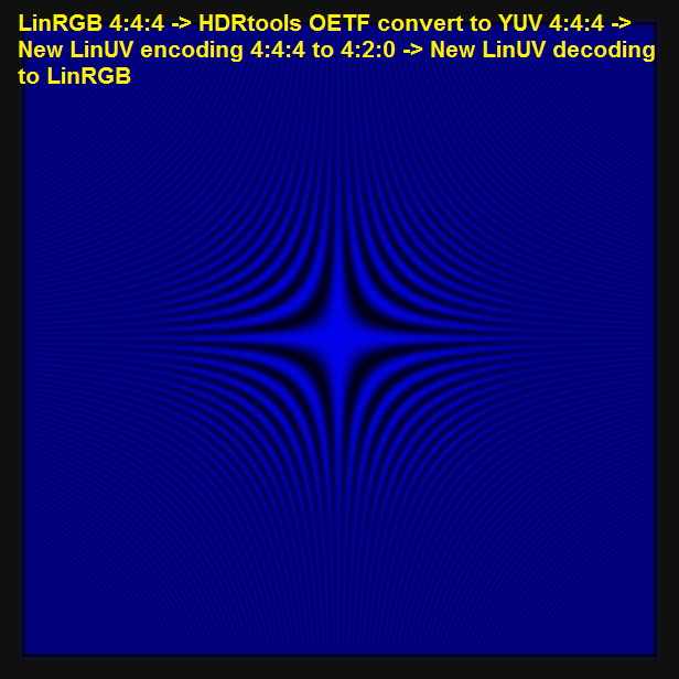

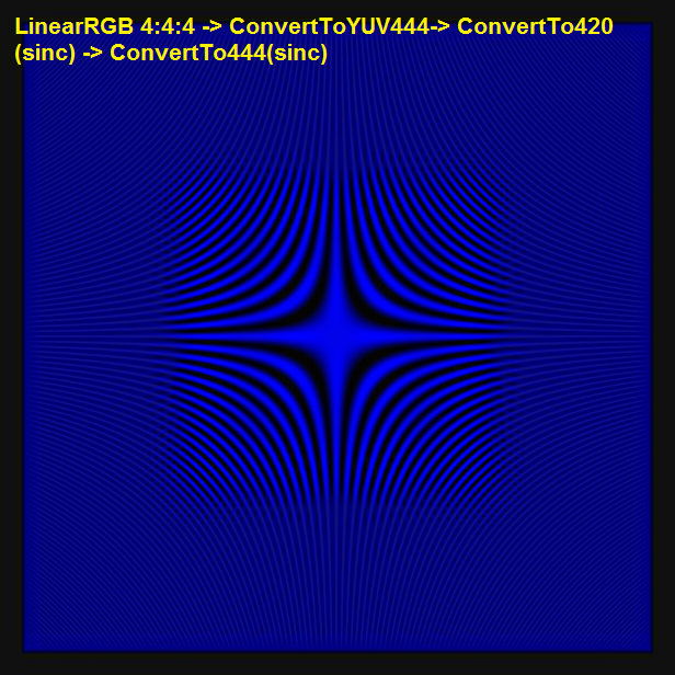

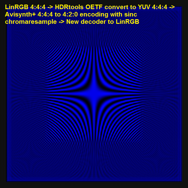

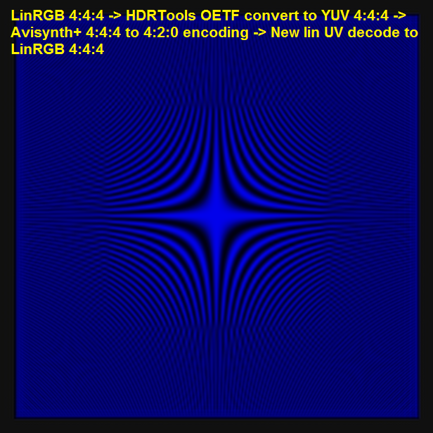

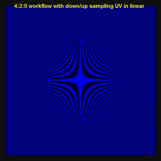

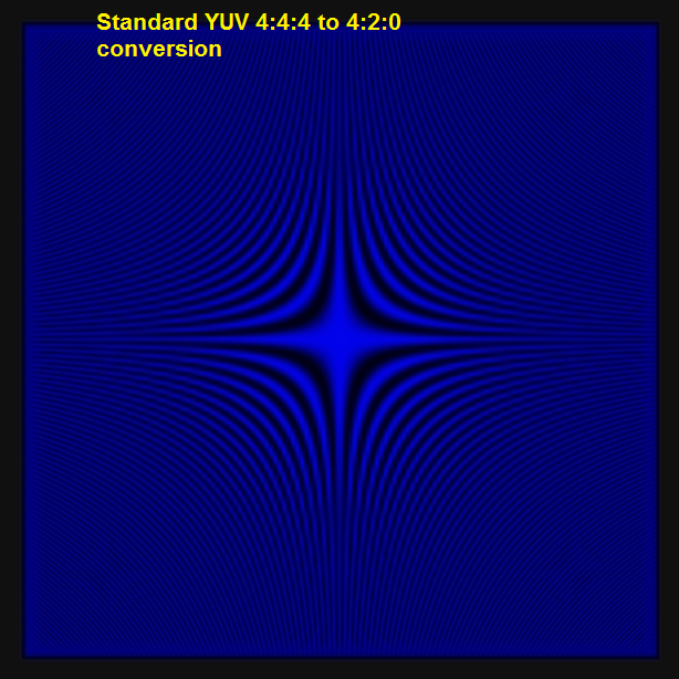

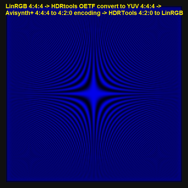

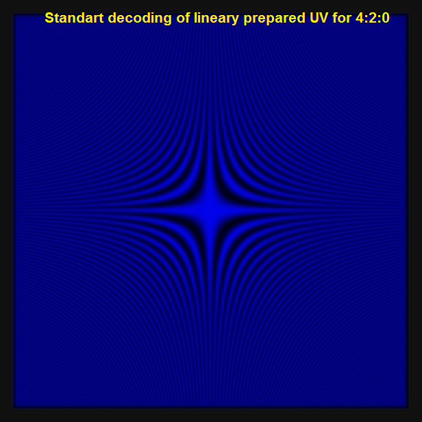

Some idea about less destructive conversion from linear RGB 4:4:4 typically in the main resampler path back to storage YUV 4:2:0 and decoding back to display linear 4:4:4 RGB.
It still not 100% compatible with recommended workflow of ITU recs like BT.601 and other because it recommend to low-pass and downsample CbCr (UV) data from R'G'B' data. This example uses for UV generation separated RGB linear path with half size of the RGB linear source. And UV is generated from downsampled RGB in linear form. Also backward upsampling of UV before final convertion to RGB output linear performed in linear form.
The most debatable point of this method is how to restore the best Y' data array in the space of UV data size of 4:2:0 color format at receiver's side. Because it is skipped at 4:2:0 dowconvertor stage and not delivered in final output 4:2:0 data array. Currently is it 2x downsampling of Y' data array from input 4:2:0 with SinPowResize method in its input form (without linearing, or other magic).
LoadPlugin("RawSourcePlus.dll")
LoadPlugin("ResampleMT.dll")
LoadPlugin("HDRTools.dll")
RawSourcePlus("out16.raw", 288,288, "Y16")
ConvertToRGB64(matrix="PC.709")
RGBAdjust(r=0.01,g=0.01) # make saturated color, comment out for no color
AddBorders(10,10,10,10,color=$101010)
# here current is 4:4:4 linear conditioned RGB source
rgb_lin_d2=SinPowResizeMT(width/2, height/2, p=2.9)
ConvertLinearRGBtoYUV(Color=4)
yuv_d2=ConvertLinearRGBtoYUV(rgb_lin_d2,Color=4)
yuv_old=ConvertToYUV420()
yuv420_new=CombinePlanes(yuv_old, yuv_d2, yuv_d2, planes="YUV", source_planes="YUV", pixel_type="YUV420P16")
#create receiver Y'/2 for backward dematrix
rsv_Ydash_div2=SinPowResizeMT(yuv420_new.ConvertToY(), yuv420_new.width/2, yuv420_new.height/2, p=2.9) # test or select Y'/2 resampler engine !
rsv_YUV_new_Y=CombinePlanes(rsv_Ydash_div2, yuv420_new, yuv420_new, planes="YUV", source_planes="YUV", pixel_type="YUV444P16")
rsv_RGB_linear_d2=ConvertYUVtoLinearRGB(rsv_YUV_new_Y,Color=4)
rsv_RGB_linear_x2=SincLin2ResizeMT(rsv_RGB_linear_d2,rsv_RGB_linear_d2.width*2, rsv_RGB_linear_d2.height*2, taps=16)
rsv_YUV_x2=ConvertLinearRGBtoYUV(rsv_RGB_linear_x2,Color=4)
rsv_return=CombinePlanes(yuv_old, rsv_YUV_x2, rsv_YUV_x2, planes="YUV", source_planes="YUV", pixel_type="YUV444P16")
ConvertYUVtoLinearRGB(rsv_return,Color=4)
#ConvertYUVtoLinearRGB(yuv420_new,Color=4)
#ConvertYUVtoLinearRGB(yuv_old,Color=4)
SincLin2ResizeMT(width*2, height*2, taps=32)
ConvertBits(8)
The source test pattern is hyperbolic zoneplate generated by https://github.com/DTL2020/hpzp tool with arguments hpzp.exe 268 20 0.02.
If processing no-color data (RGBAdjust(r=0.01,g=0.01) commented out) all ways return Y-only processed image without distortions. But if processing high-saturated colors with low Y-values like saturated blue there is the difference:
Standard Avisynth+ conversion from YUV 4:4:4 to 4:2:0 and playback to linear RGB:
Linear UV path method:
Standard 4:2:0 to 4:4:4 decoding of linearly prepared UV:
DTL is offline   Reply With Quote

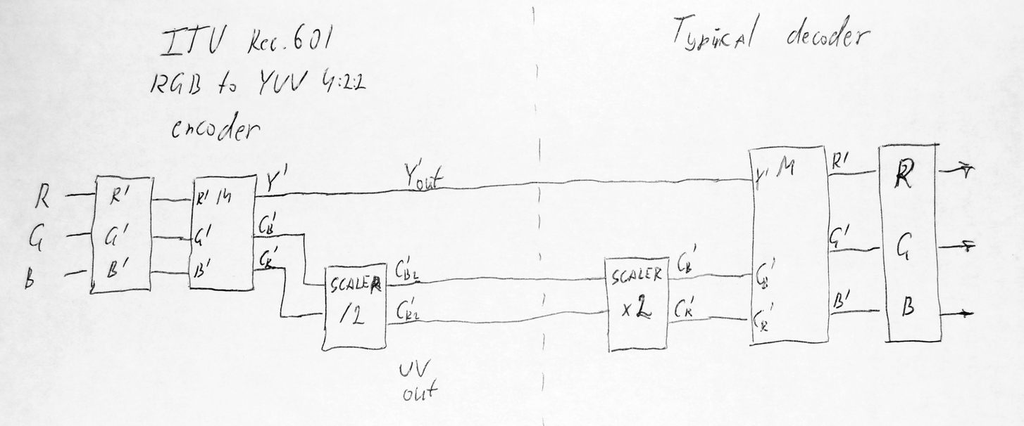

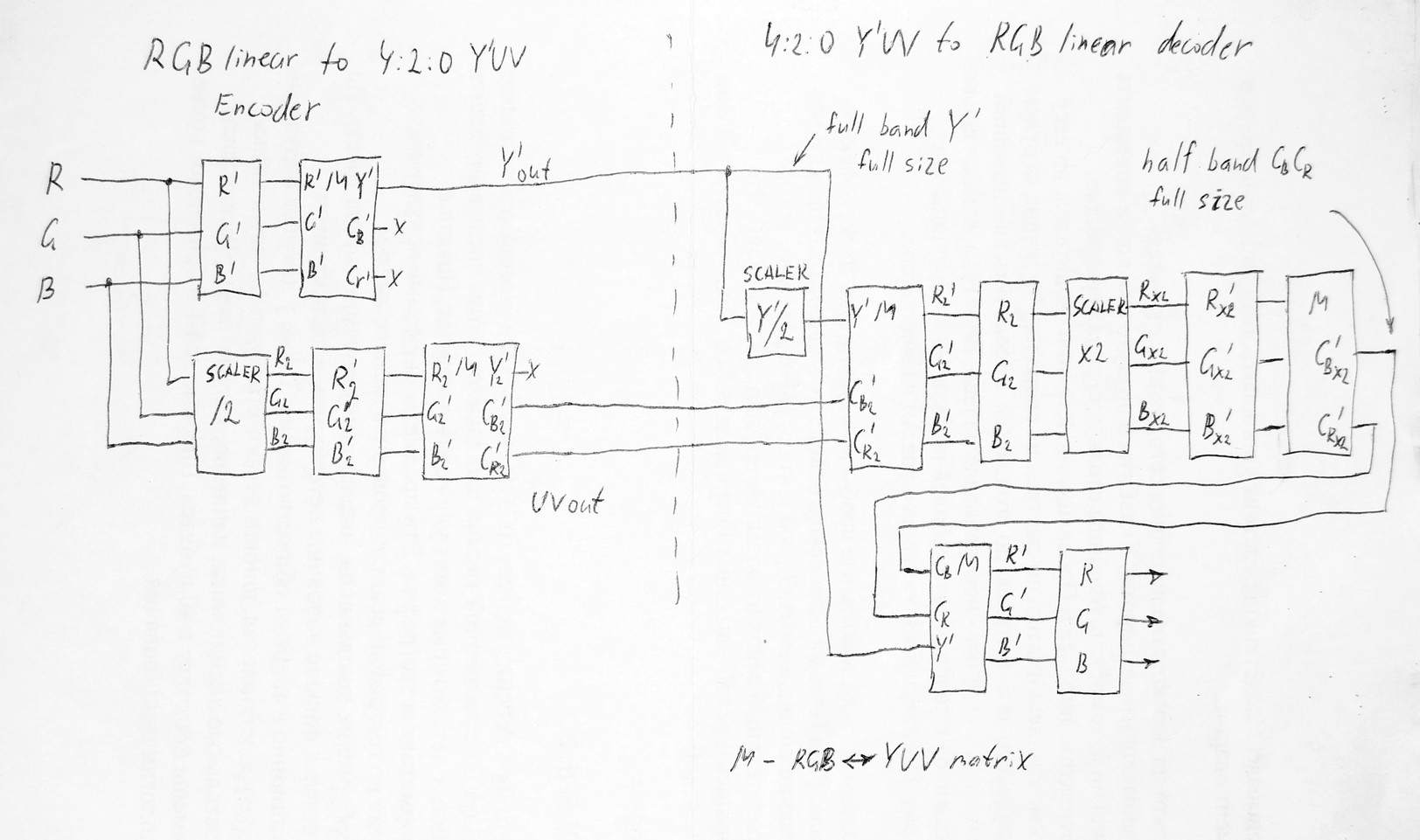

I made drawings of structural schematics of 2 different approaches for RGB to YUV 4:2:0 encoding and decoding:
Linear UV:
And 'classic' with spectrum-limiting and downsampling in OETFed domain:
" therefore going from yv12 to RGB and back to yv12 is not lossless."
If we do not scale Y plane (actual image) the conversion from 4:2:0 to 4:4:4 and back may be virtually lossles. But the downscaler in 4:4:4 to 4:2:0 must be hinted about spectral state of input 4:4:4 - do it full band (UV or RB) components (for example initial 4:4:4 full-band source) or half band (4:4:4 upconverted from 4:2:0).
Currently build-in Avisynth+ Convert() can get the chromaresample parameter but as I see can not get required arguments for kernel's adjustments and available kernels are only built-in.
For virtually lossless 4:2:0->4:4:4->4:2:0 (same size of Y planes and UV planes) we need sinc ideal LPF in scaler for both color planes in upsampler and downsampler.
For initial (production) 4:4:4->4:2:0 (really band-reduction operaion for UV) we need special spectrum shaping LPF for anti-gibbs processing like Gauss/SinPow/UserDefined and other kernels. It is not clear defined in ITU Recs but was published in separated ITU publications.
Also as I see the point of close to ideal LPF in chroma subsampled channels in ITU Recs - it helps to eliminate additional out of band components produced with scaling in non-linear domain. But if we prepare UV in linear domain it is not needed.
I will try to ask jpsdr to implement the linear UV scaling approach because it is based on already implemented functions in ResampleMT and HDRTools. In scriting form it make more non-needed calculations and in compiled binary functions may be significally faster.

Thanks for the clarification and the paper drawn schematics, they made your point much more clear.

Well - at many real footages the difference may be very small. So currently make as a functions:
LoadPlugin("plugins_JPSDR.dll")
function YUV420P16ToLinearRGB_linUV(clip c, int ColorSystem)
 Ydash_div2=SinPowResizeMT(c.ConvertToY(), c.width/2, c.height/2, p=2.7) # test or select Y'/2 resampler engine !
 YUV_new_Y444=CombinePlanes(Ydash_div2, c, c, planes="YUV", source_planes="YUV", pixel_type="YUV444P16")
 RGB_linear_div2=ConvertYUVtoLinearRGB(YUV_new_Y444,Color=ColorSystem)
 RGB_linear_half_band=SincLin2ResizeMT(RGB_linear_div2,RGB_linear_div2.width*2, RGB_linear_div2.height*2, taps=8)
 YUV_x2=ConvertLinearRGBtoYUV(RGB_linear_half_band,Color=ColorSystem)
 to_out=CombinePlanes(c, YUV_x2, YUV_x2, planes="YUV", source_planes="YUV", pixel_type="YUV444P16")
 return ConvertYUVtoLinearRGB(to_out,Color=ColorSystem)

For backward upsampling I currently think it is not needed because half-color-band path upsampling performed in RGB. It may be wrong and require additional testing. May be the half-size Y' downsampling need additional sub-sample alignment.
"If the encoder is made the "classic" way, the decoder has to be done the "classic" way too."
Test results with hyperbolic zoneplate is (Avisynth+ ConvertToYUV420() used with default chromaresample that wiki says bicubic):
The use of new method with classic encoder still gives less aliasing in valid 4:2:0 color frequencies band but can not fix out of band aliasing passed via encoder. The power of aliasing in out-of-band frequencies is about the same with classic and new decoder.
"how do you know how the encoder was ?"
It is really very big and hard question for the current digital moving images industry. It still miss lots of required supplementary metadata about spatial properties of the content. It possibly need to go up to the ITU and may be many other standard organisations asking to add new metadata fields in the ISO MPEG (TS) and MP4 and other formats. Because as I see current world is filled with lots of digital content with not equal target renderer and current standards only partially cover the required supplementary metadata. Most of metadata relative to Fourier spectrum of data is missed.
I try to use new method on some TV broadcasting from BBC 2012 olympics and it cause significant ringing at CG content and also in vertical direction of interlaced broadcast video camera data. So it show the use of long sinc kernel resizers is not valid even for part of broadcast content and the H and V Fourier spectrums are not equally processed (conditioned). Even in 2012 broadcast interlaced HD1080 video cameras do not put correct anti-gibbs conditioning in V direction. Though for broadcast TV with CRT displays it looks never was critical.
So in current form of functions with SincLin2 upsamplers it moslty good only for progressive film content without unconditioned CG titling and with equally conditioned H and V directions. For other content may be it required to change upsamplers to something more poor but universal like down to Bicubic.
It is really exist some 'perfect motion pictures world' with rules for classic DSP with sinc-based resamplers and no aliasing and ringing and real much less perfect world of awful mix of image content with partial or no conditioned against gibbs ringing and aliasing present. And it not any marked with required metadata. One reason for the non-perfect ways is because they typically looks sharper at low pixel/sample count.
I tryed to change chromaresampler to sinc in avisynth+ ConvertToYUV420(chromaresample="sinc") and with new method of decoder and with used by HDRtools ConvertYUVToLinearRGB it still passes too many out of band frequencies and cause significant aliasing in out of band for 4:2:0 area: (attempt to ConvertToYUV444(,chromaresample="sinc") before HDRtools ConvertYUVToLinearRGB change almost nothing)
With real low and medium saturated content it much less visible I think.
May be part source of this out of band aliasing is performing 4:2:0 downsampling with non-linear data. It is main point this idea about.
If skipping OETF transform (and backward) and assume out linear data as YUV 4:4:4 (adding Convert(RGB)to YUV444) classic Avisynth+ ConvertTo420 and back to 444 works better:
So performing down/upsampling of UV in non-linear domain is significant source of aliasing distortions (as expected).
OETF/EOTF operations are bitdepth compression/decompression (reversible without significant distortions) but performing spatial down/upscaling in this compressed form cause (irreversible ?) aliasing distortions.
