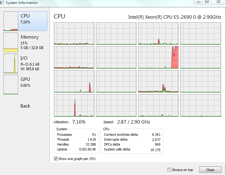

@essential,
Easiest way is to modify your Windows power plan.
Control Panel > Hardware and Sound > Choose a power plan > Change plan settings (I use "Balanced") > Change advanced power settings > Processor power management > Maximum processor state > set to 99%.
The six machines I have participating in DE mode used to sound like a vortex, all spun up to 100%. Now, with them all at 99%, it's nice and quiet and I didn't lose any speed.

Nice, thank you. I will try that.

Originally Posted by chainring View Post
@essential,
Agree with this, have done this in the past and I agree, didn't notice any real encoding performance drop. maybe a few fps at most. Will really help lowering cpu temperatures
What setting it to 99% does is limit the cpu's from going into their turbo or boost modes. Will just run at the stock max frequency.
Should be able to find instructions on the web, I don't remember now anymore how I did it, but I ended up making 2 power plan desktop shortcuts, 1 for 100% and 1 for 99%. made it easy to switch back and forth just by clicking the shortcut.
Exactly at 99% of the stock CPU clock. (on my cpu)
I wonder if the same rule applies to for example Intel 14900k where base clock is just 2GHz?
