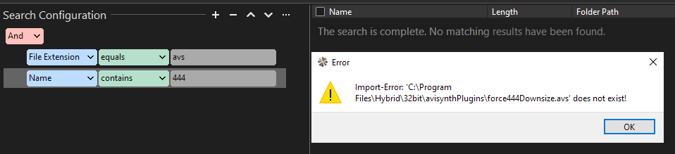

OrangeColaJuice
Join Date: Dec 2021
Posts: 16
I think that some AVS scripts are missing.
OrangeColaJuice is offline   Reply With Quote
Old 29th March 2023, 19:58   #3738  |  Link
Selur
Selur's Avatar
Posts: 7,150
I'll look into it, no clue when that script was lost.
I remember that script was used when downsizing more than a factor of 2, it tried to preserve more of the chroma info.
=> this will take me a while to find that script
Hybrid here in the forum, homepage
Selur is offline   Reply With Quote
Old 29th March 2023, 20:34   #3739  |  Link
Selur
Selur's Avatar
Posts: 7,150
Found it:
function force444DownSize(clip v1, int "width", int "height")
  Y = v1.ConvertToY8().Spline36Resize(width, height, src_left=-0.5)
  U = v1.UToY8()
  V = v1.VToY8()
  return YToUV(U, V, Y)
Uploaded it to my GoogleDrive
Simply save a copy of the file inside Hybrid/32bit/avisynthPlugins and Hybrid/64bit/Avisynth/avisynthPlugins and it should work.
