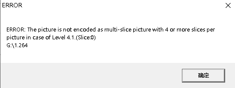

Join Date: Sep 2022
Location: Japan
Posts: 30
FRIM_ x64_ version_ 1.31 Whether MVC can conform to Blu ray 3D
Scenarist BD V8 MUI Tips
FRIM Encoder version 1.31 - Win64 (build: Mar 8 2020)
- based on Intel(R) Media SDK
Media SDK impl HARDWARE (2) - D3D11 (C:\windows\SYSTEM32\libmfxhw64.dll)
Media SDK version 1.35
Memory type System
Async depth 4
Input format I420
Encoder AVC
Input picture:
Resolution 1920x1088
PAR 1:1
Structure Progressive
Crop X,Y,W,H 0,0,1920,1080
Frame rate 23.976
Output picture:
PAR 1:1
Frame rate 23.976
Bitrate control VBR
avg,maximum 35000,38000
GOP structure:
GOP length 24
I-/P-frame distance 3
IDR-frame interval 0
GOP type Opened
Num of slices 6
Target usage 1 (quality)
Processing started
Frame number: 1438
Processing finished in 174.68 seconds
