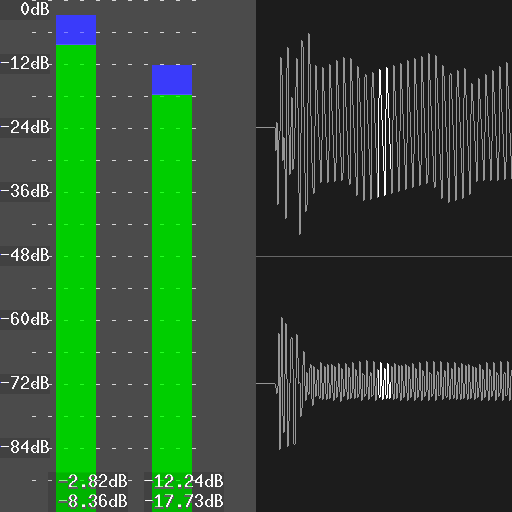

Old 22nd January 2019, 18:13   #33  |  Link
Posts: 11,407
Wonkey,
Perhaps you would like to improve on this and include in the zip, not much tested.
SEE POST #41 for updated script:
Colorbars
WINDOW    = 1        # Frames Wide = 2 * WINDOW + 1
HEIGHT    = 0.333    # Audio graphs height, 0.333 = 1/3 of result filmstrip image height.
UNDER     = True     # True, then audio graphs stacked under video, else overlay over video.
ZOOM      = 1.0      # Amplify audio signal for viewing (1.0=No Amp).
SUBSIZE   = 0.2      # Suggest 0.0(off) to about 0.5. (Range:- 0.0 <= SubSize <= 1.0) ::: 0.0 = No Frame Number,  1.0=biggest size for current clip Height (probably too big).
###### Can Remove this lot ######
TONE      = false    # Replace Colorbars tone with selected TONETYPE tone
TONETYPE  ="NOISE"   # Pick from:- "Silence", "Sine", "Noise", "Square", "Triangle" or "Sawtooth"
TONECHANS = 5        # Tone Channels Count (test channels display)
(TONE)    ? AudioDub(Tone(Length=FrameCount/FrameRate,Type=TONETYPE,Channels=TONECHANS))  : Last
###### End Of Can Remove   ######
Return WaveForm_FilmStrip(window=WINDOW,Height=HEIGHT,under=UNDER,zoom=ZOOM,subSize=SUBSIZE)

sc    = BiCubicResize(FWid,FHit) #.ShowFrameNumber
First improvement: never use bicubicresize with default parameters! It blurs:
https://forum.doom9.org/showthread.php?t=175681
Granted it's not going to make much difference in this case, but I am morally opposed to bicubicresize for this reason.
I don't think this functionality should be incorporated into waveform. A separate filmstrip plugin would be nice, and has benefits of its own without waveform - then just a shim of an Avisynth function is required to tie them together with the same Window.
Why didn't you use under=true?
Edit: dammit now I'm going to have to write a filmstrip plugin because otherwise I won't stop thinking about writing a filmstrip plugin.

Old 22nd January 2019, 18:49   #35  |  Link
Posts: 11,407
OK, fixed to
sc    = BiCubicResize(FWid,FHit,b=-0.5,c=0.25) #.ShowFrameNumber
From here:- https://forum.doom9.org/showthread.php?t=174496
Bicub_b, BicubicResize() b and c args. (If supplied as args, BEST SUPPLY BOTH Bicub_b and Bicub_c)
Bicub_c Default:-
DownSize b = -0.5, c = 0.25, Groucho2004,Didée:- https://forum.doom9.org/showthread.p...16#post1802716
Upsize, b = 0.0, c = 0.5, Catmull-Rom spline, sharp.
Avisynth BicubicResize() defaults are:- b=1.0/3, c=1.0/3
I meant to just include avs in zip, it does a fair job, mod as you will (change resizer if you will).
EDIT: Script should be sufficient for a filmstrip, dont bother with new plugin, more work for little return.
EDIT:
Mod as you will.

Old 23rd January 2019, 00:35   #39  |  Link
Posts: 11,407
Post #33 updated, moved Subtitling into function.
EDIT: Added Height, and Under args.
EDIT: How would Vegas et al, show non existing end frames, where eg WINDOW=1 (3 images wide),
at Filmstrip result frame 0, would image & audio for image representing frame previous to frame 0
be shown same as image for frame 0, or would it be eg BLACK/GREY and with silent audio,
or something else ???
eg this one, what should left image contain ? [current frame is center image 0 with hi-lited audio]
EDIT: Wonkey [NoteToSelf: Must remember to get my vowels right],
I thought there was a problem in WaveForm, as it shows audio for frame prior to frame 0
#AviSource("D:\G.avi")
Colorbars
Trim(0,-100)                        # Does NOT fix AUDIO [Should trim/pad audio to same length as video]
FIXAUDIO = False                    # On showing Frame 0, IF TRUE, Nullifies audio for frame=-1
(FIXAUDIO) ? ShowFrameNumber : NOP  # If ShowFramenumber, nullifies audio for non existing frame [returns null audio for invalid audio ranges]
WaveForm(Window=1)
FIXAUDIO= TRUE fixes problem and shows null audio at frame -1 [ShowFrameNumber filter fixes caching problem in Colorbars],

EDIT: Wonkey, x64 dll (v0.3 zip) seems not to have the Marks arg, perhaps an older version dll.
Update on WaveForm_FilmStrip(),
Frames prior to frame 0, and after FrameCount-1, shown as black, and without frame numbering.
Colorbars AUDIO prior to frame 0, and after FrameCount-1, now shows as silent, was driivng me nuts that Trim was not trimming audio [or rather that it was not making invalid audio silent].
[DelayAudio(0.0) does a proper trim on the audio, thank goodness].
EDIT: Added ShowAudio arg.
EDIT: SCRIPT_REMOVED: See post 41
Showing @ frame 0 where Window=2.
