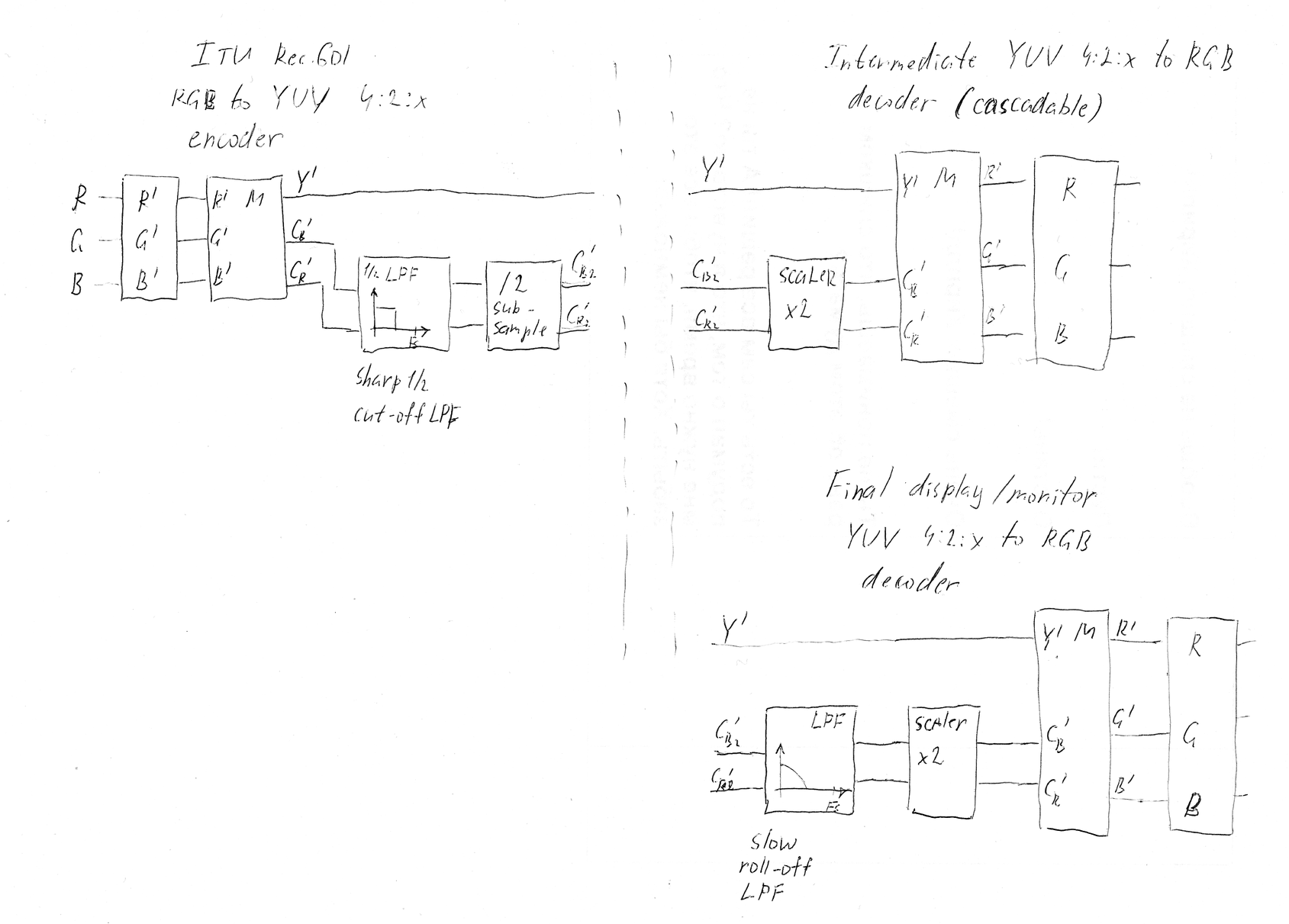

Oh - it looks some hidden feature not clearly typed in old rec.601 standard but being non-significant at time of analog displays in PAL:
https://tech.ebu.ch/docs/techreview/...rec601_bbc.pdf
More satisfactory was the consideration of chrominance filtering which recognized the need for
sharp-cut filters at all conversions except the last one. This allowed the bandwidth needed for
chroma-key and other processing to be retained through the system; however, the inclusion of a
slow roll-off in the composite coder for analogue broadcasts or in the picture monitor for direct
component signals avoided the dreadful chrominance ringing that would otherwise occur.
So for the all production chain except final display YUV->RGB conversion the spectrum-limiting LPF need to be ideal (hard-cut off) and suppression of Gibbs-ringing at time of rec.601 system assumed to be at the end of chain in the Cb Cr (non-linear) data. I.e. 'digital' rec.601 system actually designed to be ended with 'analog' PAL coder with slow roll-off of UV filters inside valid frequencies. And only in this case the chrominance ringing will be fixed (mostly). For 'full-digital' chains it mean there must be 'conditioning' in OETFed domain filter in the display YUV->RGB conversion. It can be in simple form simulated with Blur() at UV channels. Though the exact filter responce looks like not standartized and lost in the past.
For the 'linearUV' functions above it means bool ColorFullBand param need always be 'false' and can be removed. But the final YUV(subsampled)->RGB transform for display or monitoring need to be checked for having non-sharp cut-off LPF at UV channels.
I update the Rec.601-based chroma subsampled system 'classic' drawing with 2 versions of decoder to RGB - the cascadable and 'final display/monitor' :
https://i2.imageban.ru/out/2021/09/1...aaaa704e86.png
And it looks for the tasks of scaling in linear domain the 'monitor'-type decoder must be used to restore RGB in least distorted form as possible.

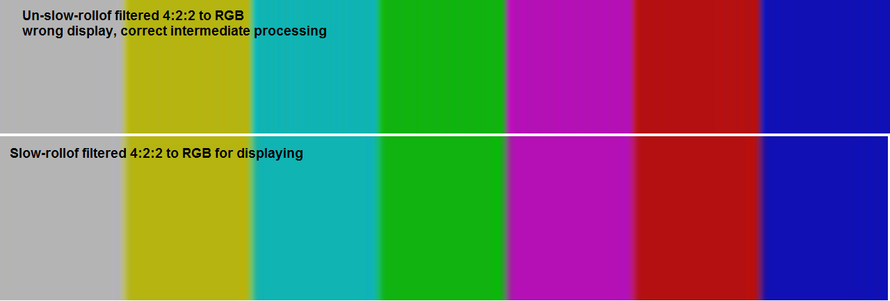

Results really shows difference:
The build-in Avisynth functions ConvertToYUV422() and ConvertToRGB24() looks like designed to be 'average' between ringing and sharpness of transients. So when using built-in functions the difference is lower. But using that functions may cause more colour-sharpness degradation if using for mult-stage processing.
In the example above the UserDefined2ResizeMT() with (uc,src_left=0.001,uc.width,) params used to enable filter-processing (convolution with kernel) without actual resizing of UV channels. As filter with slow roll-off.
The adjustments of b and c params allow to adjust of colour-sharpness because exact required filter response looks like non standard-defined.
