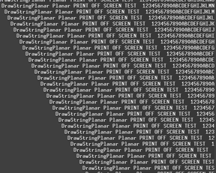

EDIT: A Few screens from DDigitTest (with a few Info.H screens)
DDigit MONOLITHIC Renderer at YV24
Names
One Pixel At a Time Col
Off Screen
One Pixel At a Time Mono
Color Codes
Vertical
One Pixel At a Time Diag
Full Character Set (Identical for Info.H)
Info.H Renderer Tests @ YV24 (with synthesized InfoF.H support)
Info.H Off Screen
Info.H One Pixel At a Time
Info.H One Pixel At a Time Diag
Info.H Control Codes
EDIT: Above images seem to be all broken, sorry.
EDIT: Fixed.
