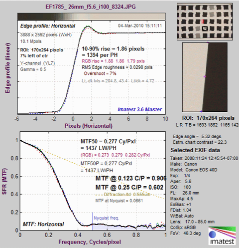

http://www.imatest.com/docs/sharpness.html
The use of Picture Height gives a slight advantage to compact digital cameras, which have an aspect ratio (width:height) of 4:3, compared to 3:2 for digital SLRs. Compact digital cameras have slightly more vertical pixels for a given number of total pixels.
