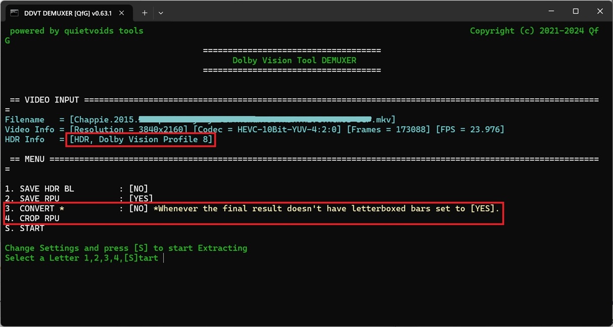

A Bug in DDVT Tool or a Problem with Dolby Vision Profile 8?
I seem to have run into a bug in DDVT tools. Each time I try to extract a Dolby Vision Profile 8 RPU, the option to enter a '4. Crop RPU' goes blank. Instead, the 'Crop RPU' option moves to '3. Convert *':
When I enter '4' to set the 'Crop RPU' option to 'Yes', it is the 'Convert' option that changes to 'Yes' but the 'Crop RPU' option remains unavailable:
Thereafter, DDVT duly extracts the RPU, but when it's time to inject that RPU back, it gives a 'RPU does not match video' and 'video does not match RPU' message.
This problem occurs every time when the RPU is of Dolby Vision Profile 8. I've never run into this error in DDVT when the RPU is of Dolby Vision Profile 7.
Any ideas whether this is a bug in DDVT tool or might it be an issue with Dolby Vision profile 8?
