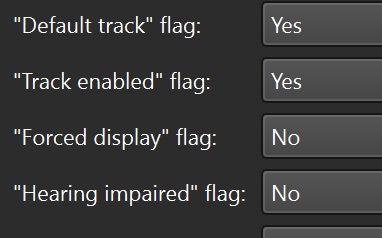

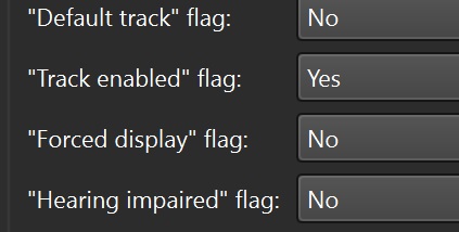

Do we have an option inside MKVTOOLNIX to:
- Always tell a language for audio/subtitles should be the default one;
if others are present, like spanish, they should be marked this way:
For example:
File has 2 audio tracks, EN and PT; plus 2 subtitles, EN and PT.
All EN should be like picture #1, all PT not default (#2 ).
Perenista is offline   Reply With Quote

No, there are no options that do exactly what you want.
