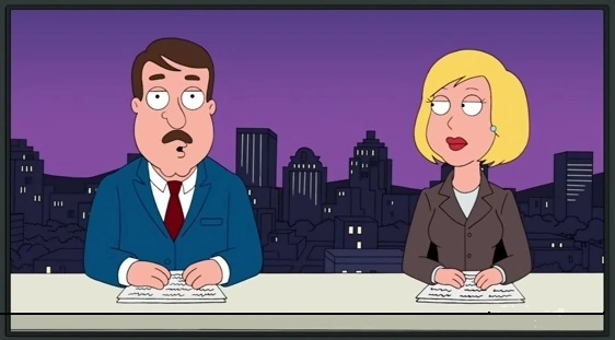

I vaguely remember playing around with the AQ strength for animation years ago and deciding to keep it at 1.0, because if I remember correctly, there was more likely to be banding in gradients when using lower AQ strengths. The background in this image is the sort of thing I'm referring to.
