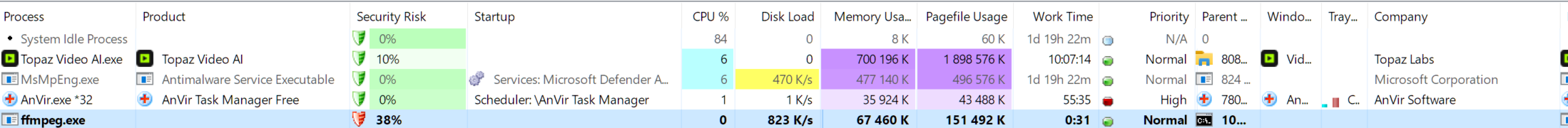

No idea what you are showing me there (ffmpeg.exe ???).
Show the CPU cores graph.
Also,
EDIT: On your Task Manager Details TAB, is your RightClick Player_appName/Set_Priority set to anything other than Normal ?
answer above.
EDIT: Gone t' pub.

Yes, I'm running the script through ffmpeg.
Now I've running compression, so I'll paste it later. But don't expect 0% to be visible there
