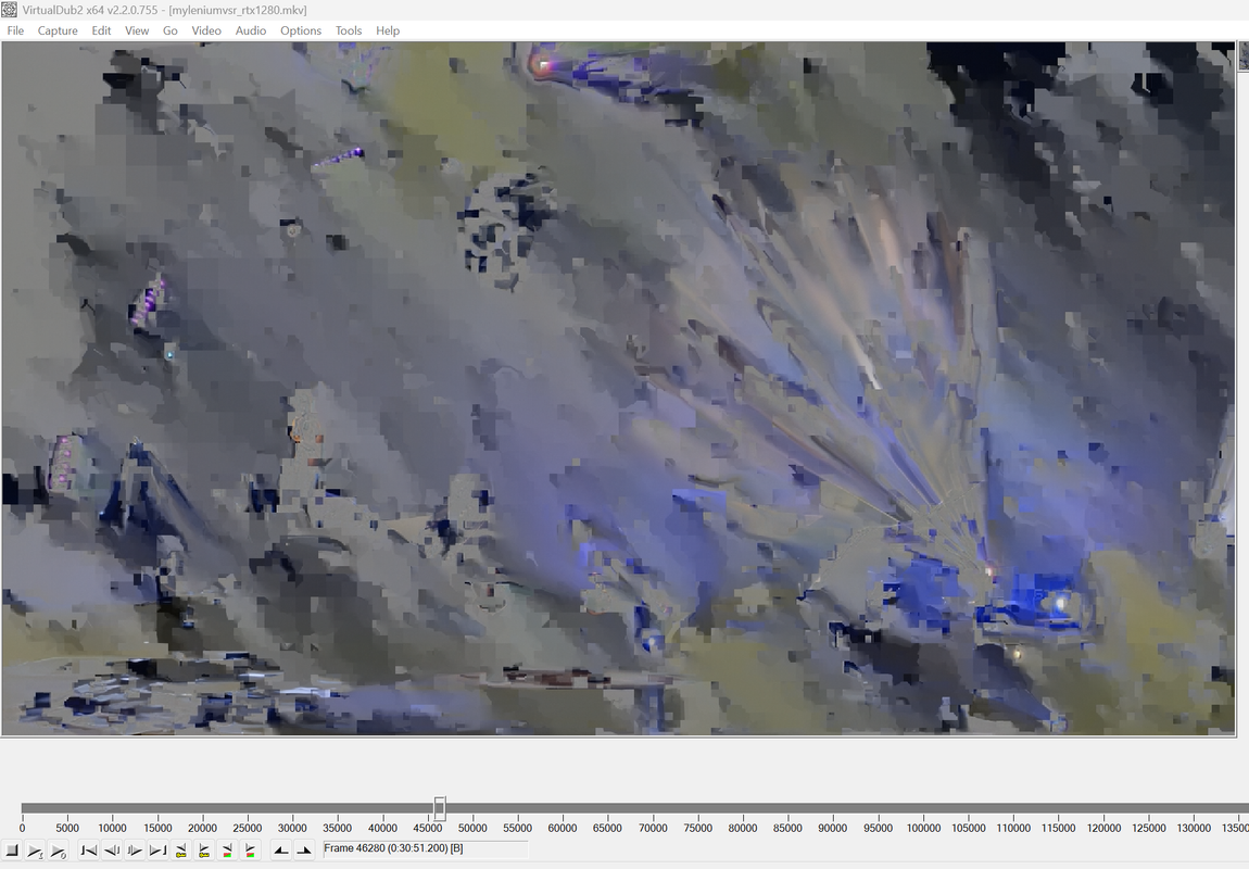

Do you know why I get artifacts every time I try to play any H.265 10-bit video in VirtualDub? The issue is very easy to reproduce with basically any 10-bit video encoded with H.265 codec. When played back, about 50% of video is shown normally and 50% is filled with artifacts like this. What can be done? Also, when I try to convert any such video into any other format from within VirtualDub, these artifacts will be in the resulting file as well. So could there be anything wrong with the built-in decoder?
I don't have your "any video".
I have "LG Colors of Journey HDR UHD 4K Demo.mkv" and it plays without artifacts in VirtualDub2 x64 v2.3.0.829.
The 64-bit build 2.3.0.829 uses FFmpeg 7.1.1 (official build). I don't know what could be wrong there.
v0lt is online now   Reply With Quote

Thanks for replying. Upon inspection, I found that 8-bit H.265 videos also have the same issue. Could you please try playing back this sample on your end?
https://app.filen.io/#/d/022ef330-53...jgBv8dGiwdMQmi
I also tried the LG : Colors Of Journey HDR video and can confirm that it doesn't have this issue. I also have several other 60 FPS demos and they don't have this issue, but videos with more regular framerates (23.976, 25 and 29.97) have.

Originally Posted by Leo 69 View Post
v0lt,
All fine at my end when feeding VirtualDub2 v2.1.3.667 with HEVC streams extracted from 4K UHD discs.
| I've been testing hardware media playback devices and software A/V encoders and decoders since 2001 | My Network Layout & A/V Gear |
SeeMoreDigital is offline   Reply With Quote
Have you tried the sample I posted?
VirtualDub2 r44282 (release): OK
VirtualDub2 r44282 + avlib 0.7.1.220: broken
VirtualDub2 v2.2.0.755: broken
VirtualDub2 v2.3.0.829: broken

The "avlib_vdplugin" log when playing "sample.mkv" looks like this:
FFLog: Could not find ref with POC 14
FFLog: Could not find ref with POC 17
I found a similar issue: https://github.com/mpv-player/mpv/issues/3440
