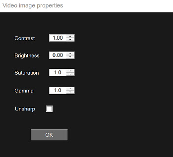

Ooh, I don't know how to do that (especially after the fact) I used the standard setting for both for UHD-HD HDR-SDR conversion. The BT709 filter with handbrake. To me the Handbrake one looks a tad washed out. I used the same, standard settings with Clever FFMpeg, HDR-SDR, etc, with Mobius and a desaturation of 2. I'm trying to use 'Brightness' on Clever FFMpeg, but I can't seem to get the setting right, I guess I'll just hafta experiment. What's throwing me off, is I can't tell what the 'Neutral' brightness, contrast, etc., settings are. It LOOKS like the defaults already boost something, but I don't know if for example '1' on brightness means it's being boosted or if '0' on contrast means it's not affecting it. Very confusing!
Here is what the default screen looks like. So, with these untouched settings, is it already boosting something, or do I assume it is already set to a default where nothing is boosted? And, is THIS saturation setting going to override what I chose in the HDR-SDR conversion? So, should I also set it to -2 (desaturation of 2 on the HDR-SDR setting) or do I leave it at zero?

try setting brightness to 2.0
just encode a small sample for testing purposes

I already just tried .5 and it was all blown out... So damn confusing! Also, what I added above about the saturation setting coinciding with what I already set in the HDR-SDR conversion.
