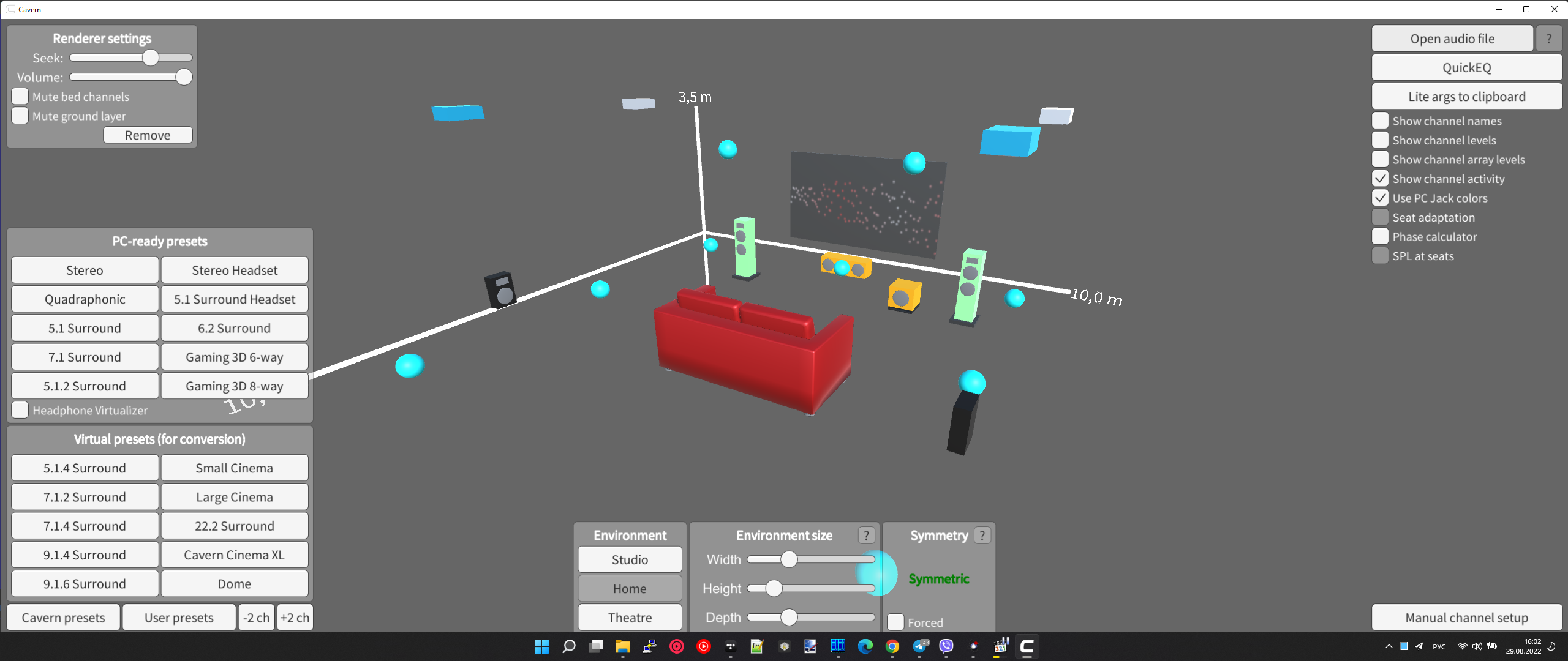

Latest commit from https://github.com/VoidXH/Cavern can now create per object 16 channel ADM with iXML. Commit before fixed key problem with decoding atmos. So it is now production ready. Unity app requires .wav and .mkv with eac3 inside to play objects' Brownian motion: see https://photos.app.goo.gl/biAubMWnT8AM18Xm6
We really need to compare ADMs.

You can also create a separate XML + WAV file!! That is done on the last saving state in explorer.exe window.
I also opened an issue that talks about how EAC3 is more than 16 bit technically (and even provided a workaround to force initial 24 bit), I checked two 24 bit file (silence is 0x00 in to 24 bit, but 0xFF in case of doing 16 bit --> 24 bit), one of which was done from default 16 bit ffmpeg wav (a bug really, I asked everyone on the team to fix it, but I suppose they are afraid it will break too much).
I also created an ADM with iXML inside and detached XML using that workaround!! Guys, please check in Dolby Tools and Nuendo + Davinci (no need to use detached XML). Thanks! I want to know it renders the 16 objects correctly using panning position metadata! https://disk.yandex.ru/d/adBuxVIZAG_5wg
Ah, yes, newest verion of CavernizeGUI with ADM and WAV+ADM XML: https://github.com/VoidXH/Cavern/fil.../caverngui.zip
