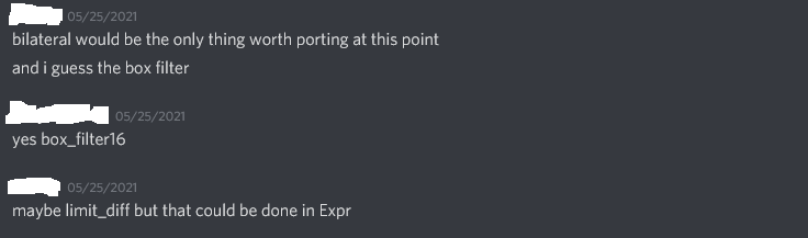

So if the question is if we need a DFT box filter, probably the answer is yes, same with binomial blur. Of course with HBD support and asymmetric blur option. I would also vouch for porting CTM (Constant Time Median) from VapourSynth, so doing a 5x5 or 7x7 median isn't as slow as it is now.
ex_bilateral() gives same output as vsTBilateral(), speed is similar as well. Dither_bilateral16() employs shortcuts to speed up the process but in my opinion the output doesn't look nice.

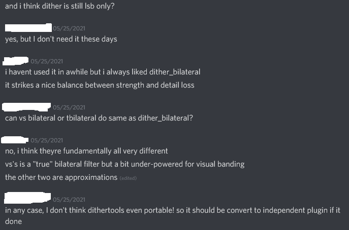

but there are people who like the Dither_bilateral16 more than others

I think it depends on the settings and the source
here a friend words
See My Avisynth Stuff
