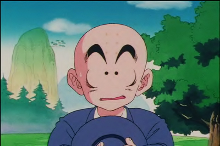

Too bad that it introduces reduction of resolution.
Original
neo_vd(threshold=10.0, nsteps=6, y=3, u=3, v=3)
KNLMeansCL(d=1, a=2, s=4, h=6, device_type="GPU", device_id=0)
One thing this filter does best is simulation of compression artefacts
threshold=25.0

Atak_Snajpera
this filter also good for remove the bad ugly dither https://i.postimg.cc/tTBKJLbL/title0...-eng002928.png
with convertbits(16).neo_vd().convertbits(8) https://i.postimg.cc/sDT48smF/title0...eng002928v.png
