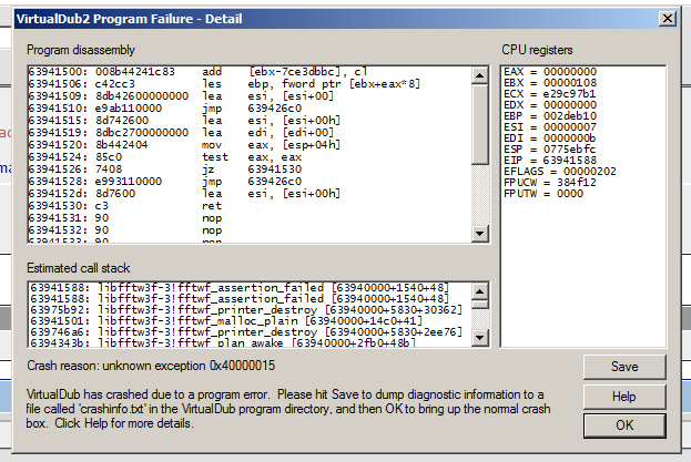

RF, With your script on x64 into VDub2 I get system exception, seems to be stack corruption

On x86 into VDub2 I get a sort of blank VDub2, nothing in frame, with 2.6GB ram use [just hangs, maybe some kind of recursive stack exhaustion].
PotPlayer just immediately closes without any indication of error.

EDIT: For rf scipt on x86, I removed AvsRecursion.dll from SysWOW64 and I get multiple "This Application has requested the to runtime to terminate in an unusual way" message.
In VDub2 error alert I get an "Crash details (best guess as to cause) - An Exception occurred in module libfftw3f-3".
Yep, just debugging the same problem, it's inside dfttest.
I have fixed the problem.
Good news: the script is working fine.
A new version of dfttest will be needed, I'll ask DJATOM if he wishes to maintain it further or I can make the update.
Any more wishes on dfttest?

EDIT: For Avs Neo, functions within Scriptclip (when Scriptclip @ main script level, ie not within script function) had no access to local vars at main level.
This does not seem to be the same problem as with NEO.
Yep, my another test case is srestore, "I don't know what "dm" means" in Neo, it appeared 1.5 years ago, my cherry-pick is some months before that point, thus the problem is not exhibited.

Well if already figured out is dfttest, and easy fixed then is looking quite promising for MT stuff.
There was no problem with the fft3d libs then ?, all A.O.K. there.
Yep, halt cherry pickin' where NEO prob is first exhibited, good call
Parts of FFTW3 are not thread-safe
pinterf is offline
-Vit- did some changes back then to fix that https://forum.doom9.org/showthread.p...59#post1423459

Originally Posted by real.finder View Post
HBD and Y*, and if it possible to add something to make it easier/faster in motion compensation usage
So it supports 16 bit only through lsb?
pinterf is offline
Old 23rd March 2020, 12:35   #5257  |  Link
real.finder
Join Date: Jan 2012
Location: Mesopotamia
Posts: 2,685
I can't see it how.
seems only plugins source in the Package, it has only the modded dll's of fftw3 and libfftw3f-3 here if you want to test https://www.solidfiles.com/v/p5eAgABYgRyVV
edit: I just tried, seems it not fix it, I get same as StainlessS
but with mpc
yes, no one added HBD to it yet, there are vs port https://forum.doom9.org/showthread.php?t=171678 maybe it can help
See My Avisynth Stuff
real.finder is offline
Old 23rd March 2020, 13:10   #5258  |  Link
pinterf
Join Date: Jan 2014
Posts: 2,527
Anyway, dfttest itself had to be modded. Nothing to do with fftw3, but calling its plan should be thread safe even if the filter was set to MT_MULTI_INSTANCE.
pinterf is offline
Old 23rd March 2020, 13:41   #5259  |  Link
pinterf
Join Date: Jan 2014
Posts: 2,527
real.finder, StainlessS:
pls. test this one.
https://github.com/pinterf/dfttest/releases/tag/1.9.4.4
Just a quick update for MT test.
pinterf is offline
Old 23rd March 2020, 14:10   #5260  |  Link
Posts: 11,406
Well it dont crash at all for me, however, I've never actually ever used it, unless as a requirement of some script function,
dont even know how to use it. [Think I'm gonna have a nap, I'm a bit knackered].
