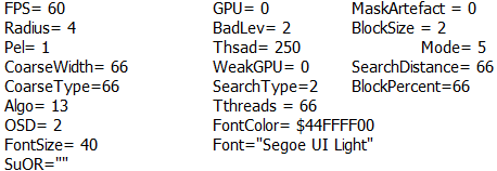

~_~ I'm not very stupid (and not very smart), just AviSynth is closed for understanding. You need use knowledges and logics from ~1990. It could be funny if you scare you grandson 'we had to use eval(""" """) widthout highlight instead of {}, we set filename in scripts by hand and them did not works without it', but using it in present is not funny. I still can not get why avisynth can not do processing in realtime. SVP does it, but svpflow1 based on mvtools2 and as I know svpflow2 (frame rendering plugin) based on another plugin.
>Most I ever do in a player is change aspect ratio or switch on subtitles, pretty much nothing else.
As I know you used interframe
https://forum.doom9.org/showthread.php?t=160226&page=48
But its dead and uses his own and very weird logic which has nothing to do with reality.
I just translated svp logic from js to avisynth and it works mostly like svp. Only ofter that I gen knowledge that natively avisynth can not render in realtime O.o
