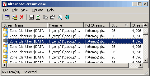

Old 24th April 2019, 13:22   #231  |  Link
Posts: 11,389
problem where eg dll has been downloaded from another computer or internet, and is blocked by the system because of this, you need to remove NTFS Alternate Data stream for the file.
Problem already posted about here[and some dozen posts following it]:- http://forum.doom9.org/showthread.ph...71#post1837271
Solution, can Unblock via file Properties[as shown by above image arrow] , or use SysInternals Streams.exe or easiest found so-far is to use NirSoft "AlternateStreamView"
which allows mass removal via "Delete Selected Streams" menu option.
AlternateStreamView:- https://www.nirsoft.net/utils/altern...a_streams.html
Below showing the Zone.Identifier Data that needs removal.
NOTE, some of Nirsoft tools may flag an Antivirus warning about PUP's (potentially unwanted programs), as many of its utils are sys fix tools to show passwords and such.
All Nirsoft tools are hi quality top notch tools and are nothing whatever to worry about [EDIT: So long as you download direct from NirSoft].
EDIT: After scanning all my drives, I found I had hundreds [if not thousands] of blocked files.
EDIT: Files are so blocked for your protection, only unblock if you think they are safe [non-malware].
EDIT:
To STOP all downloaded files from being blocked by system, under XP with GpEdit.msc, [Group Policy Editor].
    gpedit.msc
    User Configuration > Administrative Templates > Windows Components > Attachment Manager
    Enable: "Do not preserve zone information in file attachments"
Above GpEdit.msc does NOT have an icon in Administrator tools (bit of a secret one and already exists in basic XP, Server 2003 Admin tools install not necessary), need use Start/Run or from command line.
For a easy removal of multiple Alternate Data Streams, can move all files to FAT32 partition [FAT32 dont support alternate data streams] and then move them back again.
EDIT: Below, Registry edit for fixing the problem [folder contents].
Folder: "STOP_DownloadedFileBlocking"
File: "!!! ENABLE Switches OFF file blocking !!!" [empty text file for info only]
File: "ENABLE_DoNotPreserveZoneInformationInFileAttachments_(FileBlockingIsDisabled).reg"
Windows Registry Editor Version 5.00
[HKEY_CURRENT_USER\Software\Microsoft\Windows\CurrentVersion\Policies\Attachments]
"SaveZoneInformation"=dword:00000001
File: "DISABLE_DoNotPreserveZoneInformationInFileAttachments_(FileBlockingIsReEnabled).reg"
"SaveZoneInformation"=dword:00000000

Old 24th April 2019, 13:41   #232  |  Link
Groucho2004
Join Date: Mar 2006
Location: Barcelona
Posts: 5,034
All Nirsoft tools are hi quality top notch tools and are nothing whatever to worry about.
I second that, they have very useful tools.

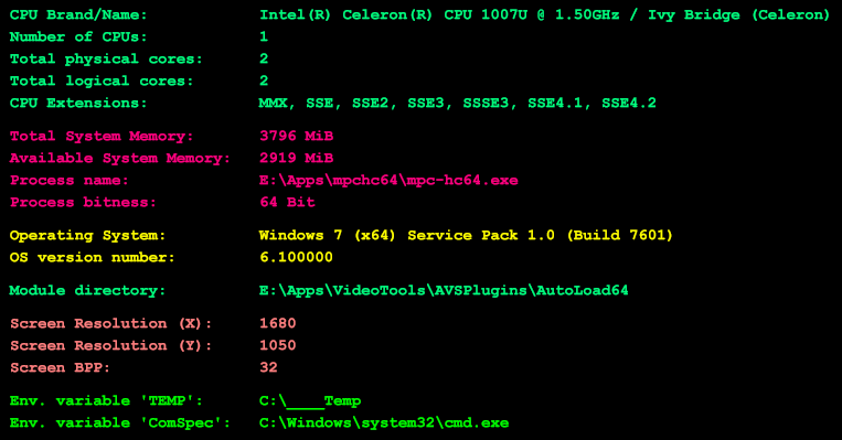

SysInfo plugin
Not exactly a new Avisynth plugin but I'll post it here anyway:
This plugin returns info about OS/CPU/Memory/Screen/etc.
Details in its dedicated thread.
