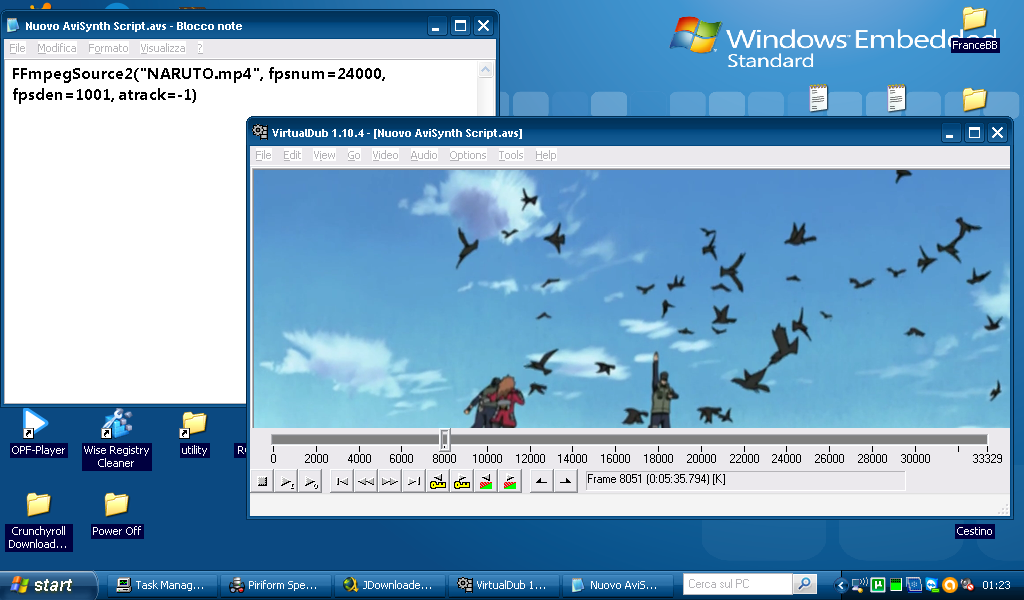

FFMS2 v 2.23 - Windows XP
Link removed
Yep, it's working!
There are several dlls you'll need to put in your plugin folder because FFMS2 uses some APIs that are not natively available in XP.
(you may get some "weird" error at the startup, but it's just a warning, it will load)
Dlls are x86 only.
Enjoy!
