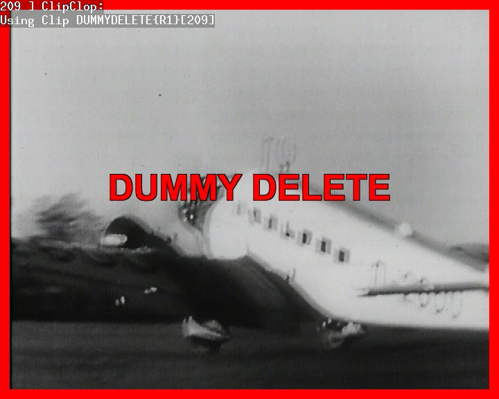

    FrameSurgeon will not actually delete frames, but only mark the frames with some "DUMMY_DELETE" type subtitle in red,
    deleting them for real would screw up any further edits, plus you can scroll back and forth to see what
    frames will be deleted and perhaps spot any mistakes). Save your Command.txt file, you can now run the same client
    script with Final=True,Show=False to edit the clip for real, job done.

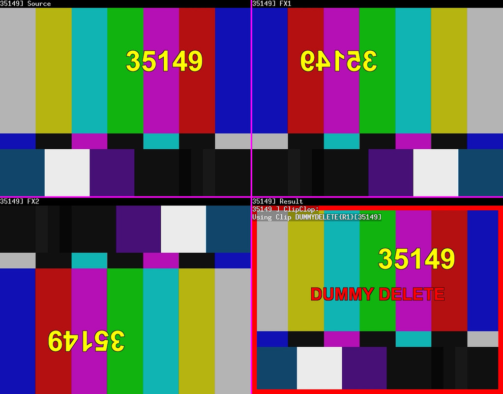

*** FXd clips (where d is Digit 1-9) are user provided to FrameSurgeon.avs function and default to source clip if not user supplied. ***

    CTRL/1              Replace current frame with same frame from FX1 clip. (FX1 n)
    CTRL/2              Replace current frame with same frame from FX2 clip. (FX2 n)
    CTRL/3              Replace current frame with same frame from FX3 clip. (FX3 n)
    CTRL/4              Replace current frame with same frame from FX4 clip. (FX4 n)
    CTRL/5              Replace current frame with same frame from FX5 clip. (FX5 n)
    CTRL/6              Replace current frame with same frame from FX6 clip. (FX6 n)
    CTRL/7              Replace current frame with same frame from FX7 clip. (FX7 n)
    CTRL/8              Replace current frame with same frame from FX8 clip. (FX8 n)
    CTRL/9              Replace current frame with same frame from FX9 clip. (FX9 n)
    CTRL/SHIFT/1        Replace range with same range from FX1 clip. (FX1 s,e)
    CTRL/SHIFT/2        Replace range with same range from FX2 clip. (FX2 s,e)
    CTRL/SHIFT/3        Replace range with same range from FX3 clip. (FX3 s,e)
    CTRL/SHIFT/4        Replace range with same range from FX4 clip. (FX4 s,e)
    CTRL/SHIFT/5        Replace range with same range from FX5 clip. (FX5 s,e)
    CTRL/SHIFT/6        Replace range with same range from FX6 clip. (FX6 s,e)
    CTRL/SHIFT/7        Replace range with same range from FX7 clip. (FX7 s,e)
    CTRL/SHIFT/8        Replace range with same range from FX8 clip. (FX8 s,e)
    CTRL/SHIFT/9        Replace range with same range from FX9 clip. (FX9 s,e)

    CTRL/DELETE         Delete current frame. (DEL n) [FrameSurgeon Frame/Range deletes are processed AFTER ALL interpolations/replacements]
    CTRL/SHIFT/DELETE   Delete range (DEL s,e)
                            NOTE. If using below "Save & Refresh" with Avisynth loaded script, then DO NOT USE ANY delete commands
                        within SawBones UNLESS, you call FrameSurgeon with arg "FINAL=FALSE". The FrameSurgeon arg FINAL=FALSE,
                        causes FrameSurgeon to NOT actually delete frames, it will only MARK those frames as being targetted for deletion
                        (the frames will show some kind of DUMMY_DELETE text subtitled onto those frames). If you do not call FrameSurgeon with
                        FINAL=FALSE, then FrameSurgeon will indeed delete the frames, but VDub2/Sawbones will have no idea that
                        it has been done, and further replacements or deletions will be on the WRONG ranges.

A SawBones created Command file may look something like this:-
(Later commands take presidence so order does matter, Interpolated ranges CANNOT be replaced[error in FrameSurgeon] but can be later deleted)
    DEL 400,449    # Delete frames 400 to 449 (AFTER ALL replacments done, ie as if at end of command file)
    I3  10         # Interp 3 frames 10 -> 12, using 9 and 13 as source
    I   20         # Interp single frame 20, using 19 and 21 as source
    I   24,26      # Interp range 24,26, using 23 and 27 as source (limited to max 9 bad frames).
    CP  40         # Replace frame 40 with frame 39
    CN  41         # Replace frame 41 with frame 42
    FX1 50,199     # replace range 50,199 with same range from FX1 clip
    FX2 300,599    # replace range 300,599 with same range from FX2 clip
        SawBones, is a compiled AutoIt script utility. https://www.autoitscript.com/site/autoit/

EDIT:
When Final=False, Delete commands appear like so (marked for deletion only, only deleted for real when Final=True)
Set FINAL=False when using SawBones.
Reason:- If a frame were deleted for real in FrameSurgeon, then any deletes following that frame would (in sawbones) all be off by 1 frame.
Off by 1 frame thing would not affect non delete edits, as deletes are processed only after all other edits are done.
(SawBones/VirtualDub2, have no idea what Avisynth has deleted before clip was loaded into VirtualDub)
One additional advantage of the Dummy Delete frames is that you can see what will be deleted when FINAL=True.

Added, FrameSurgeon_DEMO.avs
Import("FrameSurgeon.avs")
### Config ###
SHOW=True                                           # Show ClipClop OR Prune Metrics
SHOWMODE=0                                          # 0=ClipClop metrics, 1=Prune Metrics (Show deletions rather than replacements)
SCMD=""                                             # Not Using SCMD in this DEMO
CMD="DEMO_Command.txt"
DV=5                                                # 0=ERRORS ONLY, 5=FULL Debug to DebugView(Google)
STACK=True
### Source clip and Simulated replacement clips ###
src=Colorbars.killaudio.ConvertToYV12.ShowFrameNumber(Size=72,x=320,y=240)
FX1=src.FlipHorizontal              # Light denoising or whatver
FX2=FX1.FlipVertical                # Heavy denoising or whatver
### Edit or No Edit ###
CMD=(CMD!="") ? RT_GetFullPathName(CMD) : ""
PROCESS = (SCMD!="" || (CMD!="" && Exist(CMD)))     # Skip FrameSurgeon if no String nor file commands.
Result = (PROCESS) ? FrameSurgeon(src,scmd=SCMD,cmd=CMD,Show=Show,ShowMode=SHOWMODE,dv=DV,fx1=FX1,fx2=FX2) : src
### Stack For View ###
TOP=StackHorizontal(src.RtSub("Source",True),FX1.RtSub("FX1",True))
BOT=StackHorizontal(FX2.RtSub("FX2",True),Result.RtSub("Result",True))
Return (STACK) ? StackVertical(TOP,BOT) : Result
    Can use above script where DEMO_Command.txt file does not exist and will not produce error, ie use same script and Demo_Command.txt
    with VirtualDub, Sawbones, and NotePad.
DEMO_Command.txt
DEL 400,449    # Delete frames 400 to 449 (AFTER ALL replacments done)
I3  10         # Interp frames 10 -> 12, using 9 and 13 as source
I9  20	       # Interp frames 20 -> 28, using 19 and 29 as source  # EDIT: or I 20,28
CP  30         # Replace frame 30 with frame 29
CN  31         # Replace frame 31 with frame 32
DEL 1000,-1000 # Delete frames 1000 to 1999 (AFTER ALL replacments done) # EDIT: Added

Old 30th August 2017, 23:02   #11  |  Link
Posts: 10,980
SawBones/FrameSurgeon v1.04, new version see 1st post.
Posts #1 to #4 updated.
MAIN difference, can within Sawbones press a key combo to Save contents of NotePad Command file, and auto
refresh avs into VirtualDubFilterMod (now almost a requirement), so you can see edits that you have already done.
(Replacements and Interpolations done, and deletions marked (subtitled) but not actually deleted until FrameSurgeon called with
FINAL=True)

FrameSurgeon_DEMO_Cmd.txt
CP  1000             # CP, Single frame args ONLY. Replace 1000 with frame 999.
CN  1001             # CN, Single frame args ONLY. REplace 1010 with frame 1002.
I9  1010             # Id, Single frame args ONLY. Interpolate 9 frames starting at frame 1010.
FX1 1200,1299        # Replace 1200->1299 with same range from FX1 clip. (FXd clips default source if not supplied, Subtitled if Show)
FX2 1300,1399
FX3 1400,1499
FX4 1500,-100        # Replace 100 frames starting at 1500.
FX5 1600,-50         # Replace 50 frames starting at 1600. # NOTE FX5 NOT defined in script
DEL 1700,1799
DEL 1800,-100        # Del 100 frames starting from 1800
SawBones_DEMO.avs
Import("../FrameSurgeon.avs")
### Config ###
FINAL=False                 # Change to TRUE to do real DELETES (FALSE only shows where deletes would occur, ALWAYS use FALSE with SawBones)
SCMD=""                     # Not Using SCMD (string command) in this DEMO
CMD="SawBones_DEMO_Cmd.txt" # Command file, perhaps created via SawBones.
SHOW=!FINAL                 # Show ClipClop OR Prune Metrics
SHOWMODE=0                  # 0=ClipClop metrics, 1=Prune Metrics (Show remaining after deletions rather than replacements)
DV=4                        # 0=ERRORS ONLY, 4=FULL Debug to DebugView(Google)
NOERR=False                 # Set True if wanting to IGNORE FXd commands for undefined FXd clips.
                            #     (In DEMO, FX9 command is used in CMD but not supplied in FrameSurgeon call, set True to ignore that command)
# MvTools, Interpolate args (see mvTools)
PEL=2
SHARP=2
RFILTER=2
ML=100.0
STACK=(!FINAL || SHOW)          # Auto stack window OFF when FINAL==True and SHOW==FALSE
### Source clip ###
src=src.ShowFrameNumber(Size=src.Height/6,x=src.Width/2,y=src.Height/3)
### Simulated replacement clips ###
PROCESS = (SCMD!="" || (CMD!="" && Exist(CMD)))     # Skip FrameSurgeon if no String nor file commands (yet).
Result = (PROCESS)
        \ ? FrameSurgeon(src,scmd=SCMD,cmd=CMD,Show=Show,ShowMode=SHOWMODE,dv=DV,
        \   fx1=FX1,fx2=FX2,
        \   pel=PEL,sharp=SHARP,rfilter=RFILTER,ml=ML,
        \   Final=FINAL,NoErr=NOERR)
        \ : src
BSZ=4 BCOL=$FF00FF
Ssrc=src.RtSub("Source",True)   SFX1=FX1.RtSub("FX1",True)  SFX2=FX2.RtSub("FX2",True)  SResult=Result.RtSub("Result",True)
TOP=StackHorizontal(Ssrc,Ssrc.BlankClip(width=BSZ,Color=BCOL),SFX1)
BOT=StackHorizontal(SFX2,Ssrc.BlankClip(width=BSZ,Color=BCOL),SResult)
Return (STACK) ? StackVertical(TOP,TOP.BlankClip(height=BSZ,Color=BCOL),BOT) : Result
# Stack Overhead RT_Subtitle Text, with optional FrameNumber shown.
Function RtSub(clip c,string Tit, Bool "ShowFrameNo") {
    c.BlankClip(height=20)
    (Default(ShowFrameNo,False)) ? ScriptClip("""RT_Subtitle("%d] %s",current_frame,""""+Tit+"""")""") : RT_Subtitle("%s",Tit)
    Return StackVertical(c).AudioDubEx(c)
Old 31st August 2017, 03:47   #12  |  Link
Posts: 10,980
Oops, a few corrections, re-upped zip (only had 1 download, no version bump).
Post #2 correction (Final was originally another name, and default True, forgot to invert some True's to False and False to True)
Final Default False,       If False, then DOES NOT Delete any ranges, replace only. Delete Operations only occur if this arg is True.
                             Set False, when using SawBones together with NotePad and VirtualDubFilterMod (with Script Editor Window Open).
                             When False, will not do deletions, will instead show frames marked with "DUMMY DELETE" in frame center.
                             Purpose, to avoid editing errors using SawBones v1.04 "Save & Refresh" AVS, keyboard command. (Not a
                             good idea to edit clip where deletions have already been done, ie edits after first deletion, would all be wrong).
                             Change to FINAL=True, when all edits including deletions are complete, where real deletions will ensue.
                             If later adding some edits to a command file using SawBones, then set FINAL=False until editing complete.

EDIT: In re-upped zip, also made this amendment to FrameSurgeon_DEMO.avs (show STACK 6 windows, with FX1->FX4, was only FX1->FX2)
### Config #############################################
### One of below strings
SCMD="""                 # Demo Test
    CP  100              # CP, Single frame args ONLY. Replace 100 with frame 99.
    CN  101              # CN, Single frame args ONLY. REplace 101 with frame 102.
    I9  110              # Id, Single frame args ONLY. Interpolate 9 frames starting at frame 110.
    FX1 200,299          # Replace 200->299 with same range from FX1 clip. (FXd clips default source if not supplied, Subtitled if Show)
    FX2 300,399
    FX3 400,499
    FX4 500,-50          # Replace 50 frames starting at 500.
    FX5 550,-50          # Replace 50 frames starting at 550. NOTE, as not defined in this script FX5 defaults Subtitled source clip.
    FX6 600,-100         # Replace 100 frames starting at 600. NOTE, as not defined in this script FX6 defaults Subtitled source clip.
    FX7 700,-100         # Replace 100 frames starting at 700. NOTE, as not defined in this script FX7 defaults Subtitled source clip.
    DEL 800,899
    DEL 900,-100         # Del 100 frames starting from 900
    DEL 2000,0           # Del from 2000 to end of clip.
#SCMD=""
### One of below strings (CMD file is processed before SCMD, where multiple replacements on same frame)
CMD="FrameSurgeon_DEMO_Cmd.TXT" # Command file, perhaps created via SawBones.
#CMD = ""
PEL=2
SHARP=2
RFILTER=2
ML=100.0
### Source clip ###
FX1 = src.FlipVertical
FX2 = src.FlipHorizontal
FX3 = src.Blur(1.58).Blur(1.58).Blur(1.58).Blur(1.58).Blur(1.58).Blur(1.58).Blur(1.58).Blur(1.58).Blur(1.58).Blur(1.58).Blur(1.58)
FX4 = src.Sharpen(1.0).Sharpen(1.0).Sharpen(1.0)
Result = (PROCESS)
        \   fx1=FX1,fx2=FX2,fx3=FX3,fx4=FX4,

A frame from the 1st demo multi-window script in the zip.
And another from the single window template demo_2 script.
The Dummy Delete frames are just place holders used within Sawbones to show which frames have been marked for deletion,
they are only actually removed when using Sawbones / FrameSurgeon with FINAL=TRUE.
