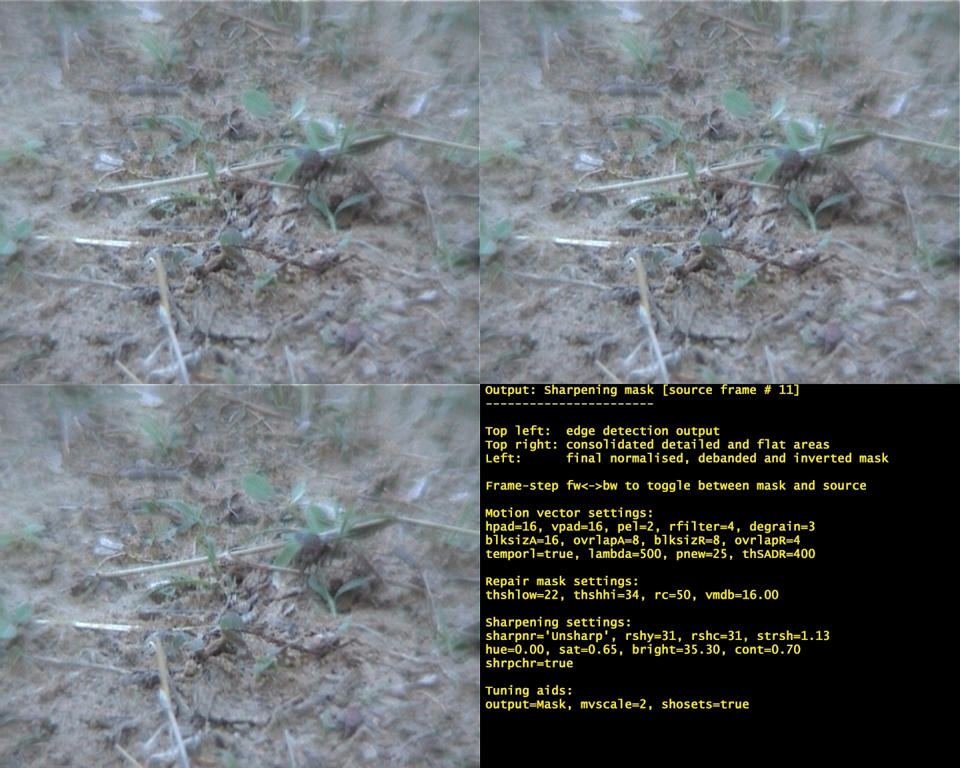

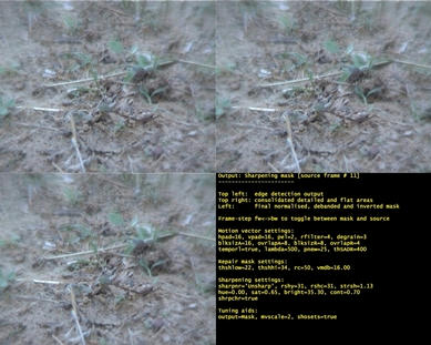

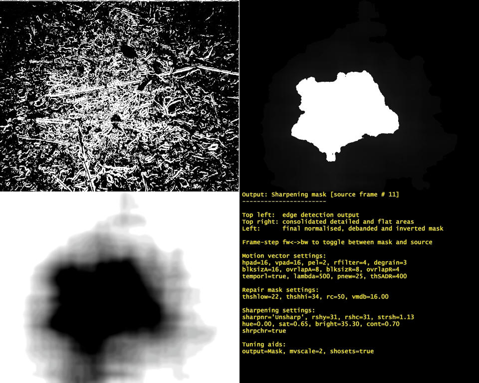

Toggling between the repair mask tuning and source displays:

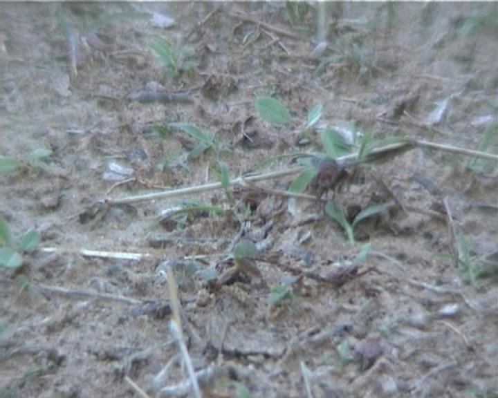

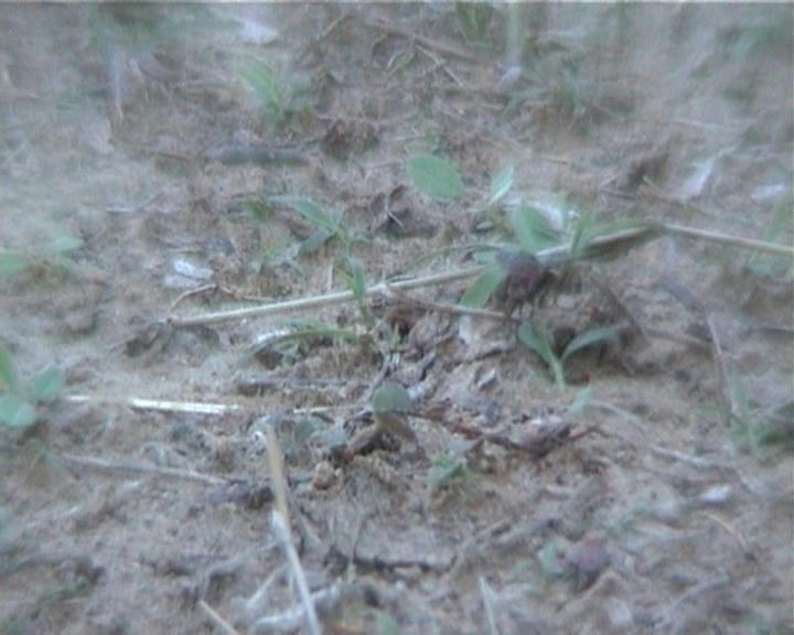

Sample before-and-after screenshots:
Hopefully this is enough to get going anyone who wants to play with it, but shout if you have any questions.
