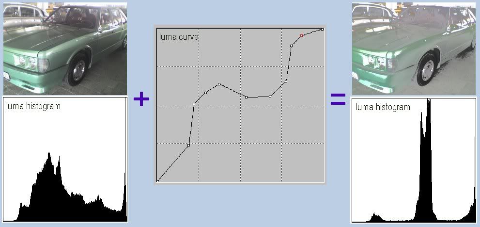

Dear Everyone, I have a problem with histogram matching. I have the original picture on the left (above). I want to make it look like the picture on the right through applying a luma curve to it. How can I figure out the curve I need by comparing the histograms? As you can see, in the above example the desired curve is known, but obviously normally I only have the pictures. I've written a little program which creates the histograms. I thought it'll be very simple to calculate out the needed luma curve, but I've just realized it's not. I tried comparing "column" to "column" but I ended up with very irrealistic curves. They didn't look like the above. There must be a working mathematical way to work it out. Any ideas? Full size pictures: http://i179.photobucket.com/albums/w...eredetikep.jpg http://i179.photobucket.com/albums/w..._elkurtkep.jpg |

Do you mean you want to reverse what is shown in the picture?
Curves work like an histogram but in a diagonal axis. Just a question, do you know any curves filter for avisynth? im very interested. In this particular case the best you can do is by eye. As you have de curve, you can try to do just de opposite. Reference on the grid and reverse the points. Much better, reference the curve graph, and copy the points position, then reverse the value numbers based on the diagonal axis.

You can't reverse such an operation in the general case. Reversal is only possible when the adjusted curve is continuously rising (or continuously falling). If the adjusted curve doesn't meet this criterium, e.g. if there is a sinus-style rise-fall-rise part in the curve, like in the given example, then the projection is not anymore bijective, and cannot be reversed. (Independent input values become the same output value. If you have only the output value, there is no way to transform that value back into some, some other, or yet another value.)

I don't want to actually reverse anything. I don't want to tweak the right picture back to the left. Normally I only have the two images, the left and the right and no curve at all. The curve is what I want to find out: a curve which makes the left image look (nearly) like the right one. In the example above, the desired curve is already there but that's because it's just an artificial example I created for further examination. So what I need is to calculate out the curve you see in the middle on the pic by comparing the two images. Is this impossible too? Last edited by zee944; 7th March 2010 at 11:19. |

I couldn't find histogram matching filter. If you're thinking of ColourLike, that's not a very useful filter and doesn't give me a luma curve anyway. Quote:
Before I did that I realized that this step won't make the 50 units the desired 56. It'll make all the luma 127 pixels 142. But I thought these steps will compensate each other and the result will be fine. Now that I've written it down I can see even more clearly why this is not working. The right logic must be more complex. Any ideas? (Perhaps I have to find out the average luma and act the opposite way below and above that gradually?) |

If you want to work solely from the histograms, then it can be done if (as Didée hinted) you assume a monotonic curve. Then you can pair off values from the two histograms in ascending or descending order of luma. |

Just a quick try, without testing (only on your sample).
MatchHistogram(img1,img2,debug=false) img2 is the target image (the right one in your example). The output is img1 with the calculated curve. Use debug=true if you want to see the calculated curve. Here is the plugin: MatchHistogram.dll It doesn't work anytime (cf. Didée), for example inverse img1 & img2 and... oups! Last edited by LaTo; 8th March 2010 at 19:34. |

int temp[2][256] = {{0}}; unsigned char curve[256] = {0}; for (int h = 0 ; h < height ; h++) { for (int w = 0 ; w < width ; w++) { temp[0][src1[(h*pitch)+w]] += src2[(h*pitch)+w]; temp[1][src1[(h*pitch)+w]] += 1; } } for(int i = 0 ; i < 256 ; i++) { if( temp[1][i] != 0 ) curve[i] = temp[0][i] / temp[1][i]; else curve[i] = i; } It works on my PC... Try to re-download it! Last edited by LaTo; 9th March 2010 at 19:57. |

My problem with pixel-with-pixel comparing you and Gavino suggested that the image geometry has to be exactly the same. But I often want to capture the luma levels of an image and apply that to another image with different content. Imagine a frame of a video which shows a house. And another frame from another video footage (recorded by a different cam) which shows the same house from another angle. Pretty similar in subject, but quite different in geometry. I have to match the luma levels, but pixel-to-pixel mapping doesn't work at all. That's why I want to work from histograms. Quote:
