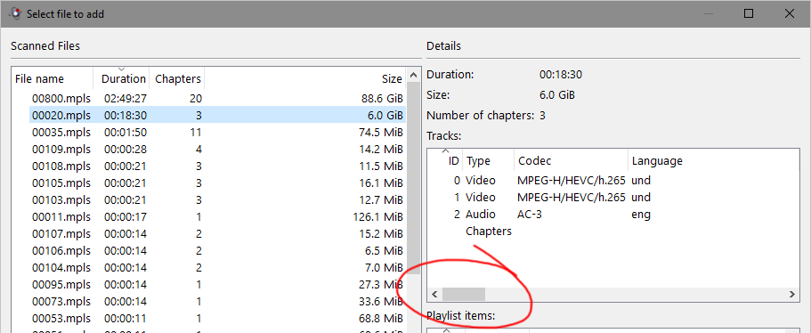

Old 5th May 2018, 00:33   #5181  |  Link
Snowknight26
Join Date: Aug 2007
Posts: 1,430
Tiny bug in at least v23:
When adding source files and selecting index.bdmv of a Blu-ray, the "Select file to add" window generally pops up, listing all the scanned playlists. If you select the first scanned file, then 2nd, then first, and so on, the tracks panel's width grows indefinitely, shrinking the scrollbar.
