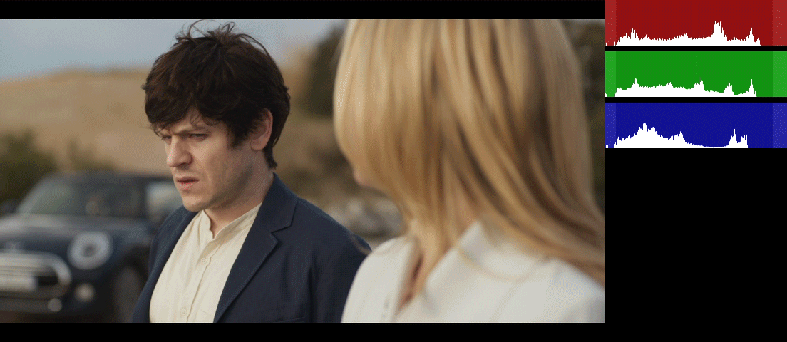

The problem is that they didn't include any info about the content: no master-display, no max/min-cll, nothing. It just says that it's HDR PQ, but I have no idea how many nits it is, which mastering display has been used and so on.
I've been asked to tone-map it to SDR and encode it to FULL HD MPEG-2 4:2:2 planar 8bit interlaced TFF, with a closed GOP, 8 PCM audio files muxed in an mxf.
In other words, an old XDCAM-50 file.
Since the content it's 25fps progressive, I'm simply gonna make a progressive flagged as interlaced, it's not a big deal, but the problem is how to do the tone-mapping.
1) Attempt 1: 65x65x65 LUT
I tried to make a LUT in order to convert the PQ curve to an old SDR one, applying a knee in order to avoid to get non-legal BT709 values.
I tried to adjust the power, the slope, and other parameters.
#Indexing
video=FFVideoSource("UHD05432.mxf")
audio1=FFAudioSource("UHD05432.mxf", track=3)
audio2=FFAudioSource("UHD05432.mxf", track=4)

I didn't manage to get any closer with Hable and Mobius.
This is as close as I got:
Unfortunately, though, as you can see, luma is pretty close but still not close enough as mid-high whites are too bright and I kinda need to bring them down without affecting the rest of the luma, however I don't know how to do it using HDRTools (if it's possible at all).
As a matter of fact, my sample got rejected once again.

After all these attempts, I decided to ask here, 'cause even though I work in broadcast and I'm an encoder, I've never been a good colorist (shame on me, I know).
I'm pretty sure there are more experienced colorists that will be able to get something that won't get rejected.
Sample files:
- Official HDR PQ: Link
- Official SDR: Link
- My tone-mapping attempt with LUT: Link
- My tone-mapping attempt with HDRTools: Link
- My tone-mapping attempt with DavinciResolve: Link
The target is to get the tone-mapping as close as possible to the "Official SDR" provided by the major, so that the Studio will accept it and it will finally go on air.
Thank you in advance.

So you have an example video of what your conversion should look like? Sounds like you could use AvisynthOptimizer to find the optimal parameters for the HDRTools script. ConvertYUVtoXYZ has quite a few parameters that could be added there as well.
You should probably try to optimize the luma first (to make things easier) and if that succeeds then adjust the chroma parameters as well. The optimizer would only need one frame to compare, if it gets that right then more could be added to make sure the conversion works in every scene.

While Avisynth Optimizer is working, I tried to tone-map manually with DGHDRtoSDR.
First of all, it only supports 4:2:0 planar and I would rather not go from 4:2:2 to 4:2:0 and then back to 4:2:2 planar.
Anyway, I managed to get the luma right, almost identical, with just a few highlights off, however Chroma is not right, as the blue is off.
(tone-mapped left, original right).
I flipped the original (right) horizontally.
Pretend that the waveform it's a function and the two screens are 2 phi (pretend that the first half is phi and the second is phi).
If they were identical, the function would be continuous in 2phi; in other words "specular" (and if you look at the waveform, it almost is):
Anyway, colors are still not quite the same and as they are not, it would definitely get rejected.

UPDATE
I got the results from Avisynth Optimizer and it actually helped me to tune DGHDRtoSDR Reinhard.
With the settings, then, I fine-tuned a bit and I managed to get pretty much the same results as the ones the major sent and the studio wants.
The results are pretty amazing and even though I still didn't manage to get the Chroma right, the luma it's pretty much the same across the whole video, which is amazing, you won't believe your eyes (but you'll believe to the waveform xD)!
Literally, hats off to Donald Graft.
Left DG Reinhard fine-tuned - Right official SDR flipped horizontally:

Join Date: Sep 2007
Posts: 5,626
your screenshots don't match the waveforms, perhaps the screenshot method was incorrect ?
e.g if you crop them, flip one back to normal and look at a rgb histogram, they don't match. Or if you convert to YUV, the waveform doesn't match either
Uh... I think that Imgur screwed the images up by converting them to JPEG and doing something wrong during the conversion. I saved them as PNG lossless directly from AVSPmod.
It's late in the night over here, I'll upload them to another host tomorrow if needed.
The posted images are pngs, and have no color tag metadata possibly interfering (pngs can have gAMA and cHRM tags that specify gamma and chromacities - different viewing applications can handle them differently; not an issue here)
RGB histogram, animated gif
Y waveform, animated gif
I'm curious about the scene with the bright glow facing the wood railing/fence. Was this current method/settings able to match that roughly or do you still have the "glow" ? Looks like clipping in the official SDR version, perhaps before even mapping, or perhaps a high cutoff level in the algorithm
