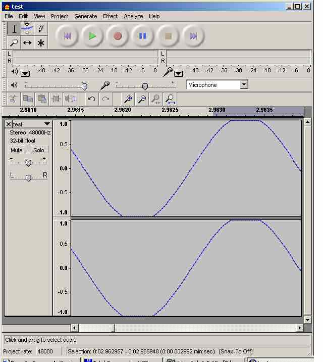

Can someone with a 3DNow capable processor please test the following script
Sounds ok on my Athlon XP 1800+/Asus A7N8X

Users with P3 should test the following script:
it loads (no vanishing)
i get a 1k tone going between left and centre of the stereo field every second or so. that what you're expecting?
there's no (audible) distortions in the tone, so i'm going to assume the conversions all maintain their integrity.
[edit]
my p3 makes a sound like a buzz. opening the avs in audition (cool! i didn't realise you could do that without an avi wrapper) reveals the positive clipping at negative fullscale, as you said.
Ok, I misunderstood the purpose
On my 3Dnow! capable athlon, the script results in clipping, just as I suppose it should. I loaded the script in vdub and saved a short .wav, which I loaded in audacity. Here is a screendump from a zoomed-in sinus.

ah! yours is doing the right thing then. mine's flipping the positive clips to the negative side. as you can imagine it sounds pretty bad

@Arachnotron, @Mug Funky,
Thanks guys for the tests (and the screen grab). It's a relief knowing I didn't stuff up the 3DNow code. Not being able to test code paths is a real downer.
