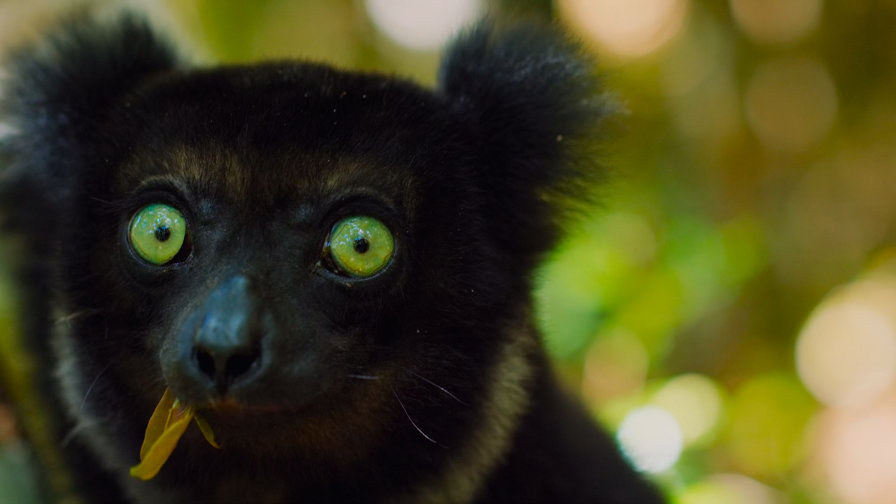

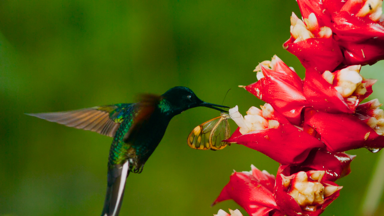

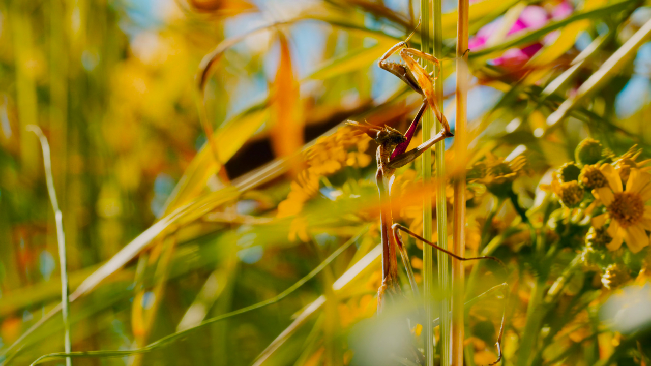

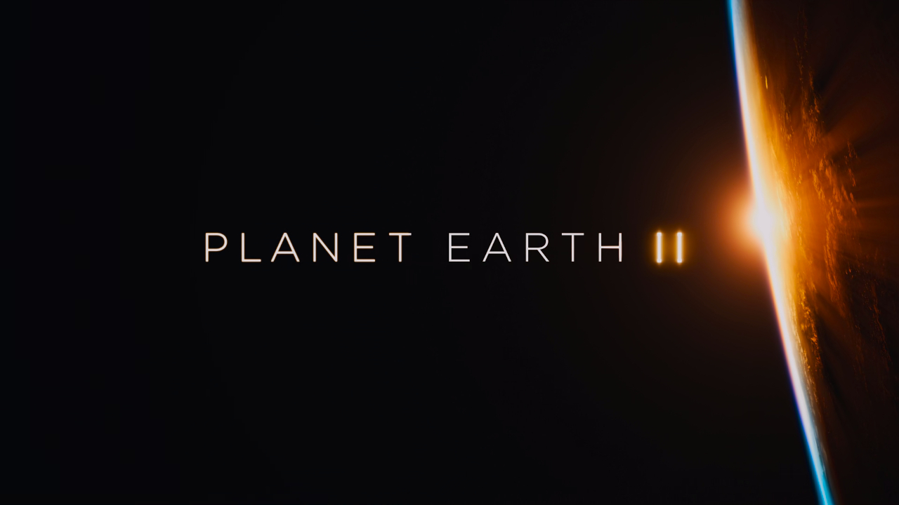

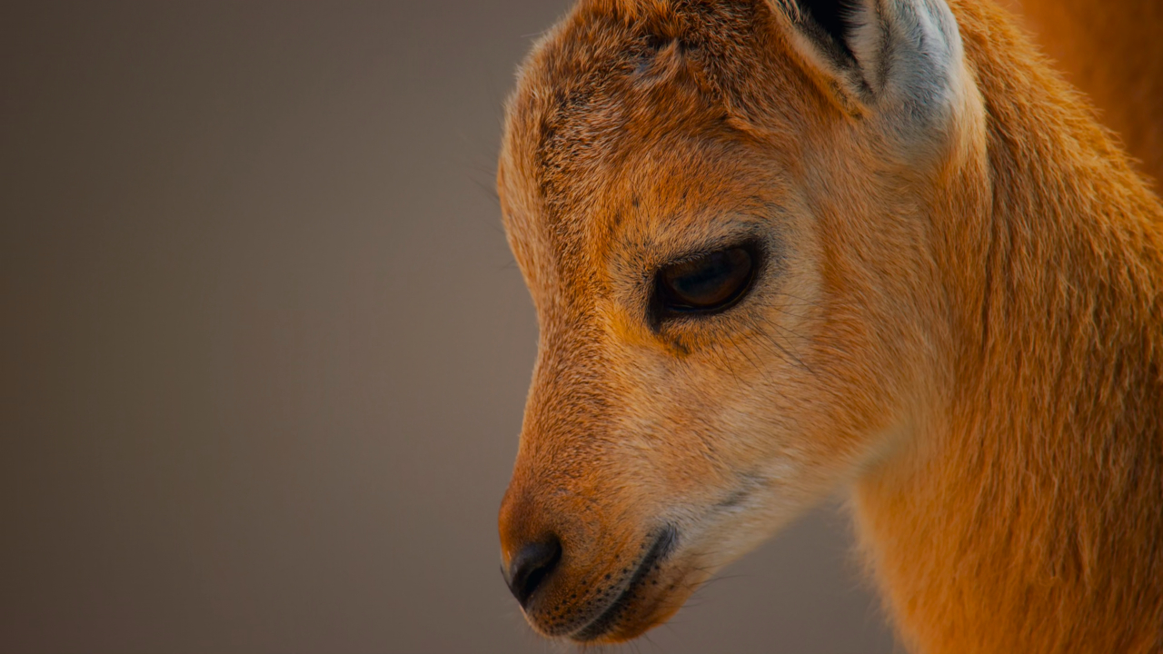

Let's put this theory to the test and compare it against HDRTools:
test1=LWLibavVideoSource("Source1.mxf")
test2=LWLibavVideoSource("Source2.mxf")
test3=LWLibavVideoSource("Source3.mxf")
test4=LWLibavVideoSource("Source4.mxf")
test1++test2++test3++test4
propClearAll()
ConvertBits(16)
bt2020=Subtitle("BT2020 SDR")
bt2020_sdr=last
ConvertToPlanarRGB(bt2020_sdr)
Cube("A:\Ingest\MEDIA\temp\BT2020_to_BT709.cube", interp=1, fullrange=1)
ConverttoYUV444(matrix="Rec709")
Subtitle("BT709 SDR LUT")
bt709_cube=last
ConvertYUVtoXYZ(bt2020_sdr, Color=1)
ConvertXYZtoYUV(pColor=1)
Subtitle("BT709 SDR HDRTools")
bt709_hdrtools=last
StackHorizontal(bt2020, bt709_cube, bt709_hdrtools)
Looks fine.
To spot the actual differences between this method and the XYZ roundtrip made by HDRTools we have to check solid colors like in those commercials in which the clipping of values outside the BT709 realm done by the LUT becomes very apparent:
The difference is pretty clear and it can be seen in both the Colgate and EE backgrounds, with HDRTools actually performing a much better approximation, while the LUT is clipping several values out as it's a simple onto conversion (as every element in the range has at least one corresponding element in the domain) but clearly not one to one (because more elements map to the same destinations). This is also due to the normalizations of value above 1 and below 0. Speaking of values below 0, inside the LUT you're gonna be able to see a bunch of zeroes, that's to avoid issues with non legal values, in fact everything negative has been normalized to 0 to avoid a repetition of frank's issue and more specifically the lut3d implementation.
When we test with real life examples, however, the difference becomes much more slim:
