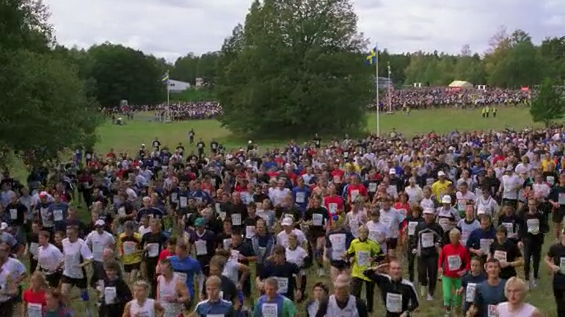

zub35
Join Date: Oct 2016
Posts: 56
HolyWu, madshi
crowd_run in motion
original 1 2 3 4 5 (downscale lanczos)
waifu2x 1 2 3 4 5
letsenhance 1 2 3 4 5
If the system detects, that you uploaded compressed JPEG, it automatically applies anti-JPEG neural network. While it is highly efficient in removing JPEG artifacts, it can also lead to some blurring. This is anticipated.
If you would like to avoid it, you can save you JPEG as PNG-24. This will skip anti-JPEGing, as well as preserve JPEG noise. If you are sure that this is something you need, we advise to do the PNG-24 thing.
zub35 is offline   Reply With Quote

madshi
Registered Developer
Join Date: Sep 2006
Posts: 9,140
@zub35, are you involved in that website? Or how did you manage to create more than 5 images? Would you mind sharing the original crowd run video? I think I only have an image, but not the video.
On a positive note, the texture in the big tree in the middle is relatively stable in motion. It's not completely stable, but it's better than I expected. However, the crowd in the very (right) background switches between blurry and sharp from one frame to the next, and some of the faces in the crowd are really scary looking, when enhanced with the hallucinated textures. Overall, I still think this algo won't work well for video.
madshi is offline   Reply With Quote

madshi, No, I am the same observer as you are. Upload more than 5 - how will allow the number of email addresses and your conscience
crowd_run and more test sample: https://media.xiph.org/video/derf/

zub35
Join Date: Oct 2016
Posts: 56
Originally Posted by zub35 View Post
crowd_run in motion
waifu2x 1 2 3 4 5
Encode x264 medium crf=25
original 1 2 3 4 5
lanczos4 1 2 3 4 5
letsenhance PNG 1 2 3 4 5
letsenhance JPG(q100) 1 2 3 4 5
HolyWu Maybe you used a 1080 sample. Alas, it is of poor quality downscale. Use 2160 sample
