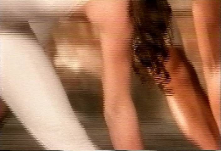

Are you talking about something like this (Notice the horizontal yellow bands across the upper arm)
I have no idea what causes this but I would love to know
source: NTSC video, capped as PAL-60 from a PAL S-VHS VCR
JVC HR-S7950 with TBC enabled, s-video cable
Terratec Cinergy 400 TV (SAA7134 chip)
VirtualVCR, 704x480, huffyuv
Arachnotron is offline   Reply With Quote

jep.
this occurs only with NTSC-Tapes.
you can try to separate the video into some stripes using crop.
then do some color-correction (hue, color-balance) to the false-colored stripes.
finally stack thos stripes back together using stackvertical.
Don't forget the 'c'!

@sharfis brain
Sounds elaborate. This particular tape is not worth it. But I have a lot more NTSC stuff still to do. Keeping as many fingers crossed as will allow me still to type.....
I don't have this tape any more, but if I run into one again I'll try if the stripes keep position when capped several times. If not, I might be able to do something with blending several caps.
@Fullasoul
Is this your problem too?

ARGH! NTSC is a crappy colour system.
i got the complete first season of "Soap" (R4, NTSC, great show if you haven't seen it), and these stripes are all over it, probably from the master tapes.
they have a soft fade in and out, so cropping might introduce some odd effects, also the stripes might move around at scene cuts or whatever (not too likely).
need a way to isolate these stripes somehow... hmm. can't think of a good way at the moment. it would most likely need a treatment like what guavacomb gives - after enough frames the plugin has an idea of where the stripes might be, and can cancel them out.
i'd personally just live with them...
now you know what NTSC stands for: Never Twice the Same Colour.

Are you talking about something like this (Notice the horizontal yellow bands across the upper arm). I have no idea what causes this but I would love to know
It also happens with pal. I see it often on skins of girls (captured from vhs tapes). This effect gets worse if your vhs tapes lie in your closet for several years.
A while ago I watched the pelican brief again (vhs-tape, recorded about 6 years ago). Full of red bands. I still have to buy the dvd one day ...
Those bands are always red or yellow (I think). Dunno why though ...

I just got an off-forum from i4004. He said lines like that can originate from physical damage to the tape from things like pausing in a freeze frame etc. and can happen to both old PAL and NTSC tapes.
Since my tape probably has been paused many times (it's a Yoga training tape) that is very likely.

how would pausing cause a line to persist over much of the recording? the line affects tape that is completely static and spooled up in a pause situation. pausing causes tape wear and probably mis-tracking, but any changes to actual information would (i would think) be confined to the tape that is in contact with the head, ie about 12cm of tape at the most.
i shall have to do some reading on this topic... i thought it was an NTSC thing, and haven't seen it on any PAL tapes (though i've not been looking).
That was just an example (pausing in freeze frame). I would imagine anything that causes excessive tapewear like fast forward with picture or slow motion (my tape), playing with dirty tape guides or dirty heads etc. etc.
I became curious about this, so I have been trying to find a site which shows what various damage to tapes looks like, but so far without success. There is plenty about tape storage and longlevity, but not with examples of what old or damaged tapes actually look like on playback.

Hello,
if these lines/bands are static (they don't move) then the following idea could lead to a solution: (this should work for all sort of static errors)
Let's assume that everything except these lines is noise. If you look over the whole length of the video, everything is moving except these lines. So if you combine all frames together (or every tenth or hundredth frame) then you should get a difference-map (one single frame) that only contains these lines. (The question is what blend-mode to use.)
This difference-map could be used to change saturation / color / lightness of the video only where thes lines reside.

I've tried this too.
The lines faded away too, when trying to layer hundreds of frames.
It seems to be some hue-problem. (phase-error within the NTSC-Signal, hehe)
