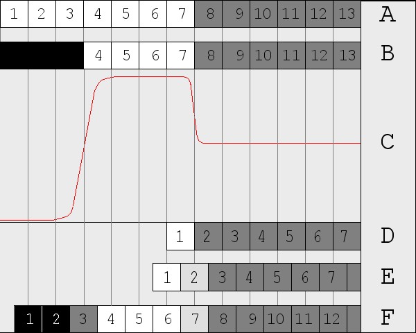

This remark is based upon something I noticed when I was making my series of captures. When I captured using the Terratec grabster at 720x576 or the Terratec Cinergy at 704x576 I got really beautifull captures that looked almost identical to the original DVD. A 1 pixel vertical line in the DVD would result in a 1 pixel wilde line in the capture.
When I did the same with the BT878 or the CX23881 the resulting lines were blurred. I was very surprised by this; the sample rate of those cards is higher than those of phillips.
Untill I realised that the phillips card were working at the same base sample rate as the DVD player, 13.5 MHz AND that the horizontal sync happened at the same time. So every pixel in my cap was positioned exactly under the analogue peak which in turn resulted from a matching pixel on the DVD.
Basically, the system was genlocked and as a result the Kell factor no longer applied.
This was a happy coincidence; the other 13.5 MHz devices in this thread had a slight offset. As a result, the peak resulting from a white pixel on the DVD is 'hit' by at least two pixels in the capture. But because the sample rates still match, the resulting gray pattern is the same for each horizontal line. This is how I know Wilberts cap was unscaled and 13.5 MHz. (this picture illustrates some of this effect)
The moment your card has another sampling rate than 13.5 (as I suspect is the case for the ATI theater range and certainly the case for the conexant cards), you will get an interference pattern. The gray pattern changes going from left to right, but after a certain interval will start to repeat itself.
From this interval you should - in theory - be able to calculate back what the sampling rate was; the pattern is caused by interference between the 13.5 MHz of the DVD peaks (or, to be more presize, the cycle time of the repeating white pixel/19 black pixel sequence) and the sample rate of the card.
Dropping a scaler over this adds a third sample rate to the mix.
And of course, if you use composite (as wilbert did) you blur the original signal throught the comb filter. It migth turn out that Wilberts card WAS genlocked, and that with a svhs leas the cap would be sharp.
In analogue caps this may not be important, unless the source came from a digital master. If that is the case, there might be a capturing 'sweet spot' where the sampling matrix matches the source.
Edit: explanation of the pic
# A. line 130 of the 720x480 mpeg file. Pixels 1-7 are white, the following ones are 50% gray
# B. On playback, the DVD player crops the first 3 pixles and replaces them with horizontal blanking.
# C. The analogue signal produced by the DVD player. The signal rises from blanking level to white level, stays at white level for about 0.2 µs and drops down again to 50% grey level. Note the rise time going from blanking level to white level (rise time is the time it takes to go from 10% to 90% of maximum signal). This is almost 0.06 µs which equals 0.8 DVD pixel! This is why a vertical change from black to white on a DVD will always result in a grey pixel in the capture. To increase the precision, the test DVD uses white lines on a 50% grey background, since going from white level to 50% grey takes less time.
# D. Theoretical capture card with the capture window coinciding with the signal resulting from DVD pixel 7.
# E. Theoretical capture card with the sampling grid 'out of phase' with the pixelgrid on the DVD. The first pixel captured contains signal from DVD pixels 6 and 7, and is white, but capture pixel 2 contains signal from the flank and results in a grey color between white and 50% grey.
# F. Theoretical capture card with the capturing window beginning before the start of the active part of the DVD signal. Because of this, two black pixels are captured on the left. The third pixel is grey, since most of the analogue signal in this area is on a slope between black and white
The above is a bit of a rambling story, but I hope you understand what I am getting at? It's just a bit of speculation on the side, but interesting. It might be complete nonsense of course.
edit2 Looking at it, the pic may not be the best illustration if what I am talking about, but it is the only illustration of a shifted sampling frame I have

1) I don't see why a 13.5MHz card could not represent either the perfectly in phase line and (D), and the out of phase line (E). Depends on how the card locks on the sync, and considering it may not be working with a full lenght signal, I'm suspecious of an insync capture. *** Forget this. I re-read your post. You got 1 of these not all the time like I thought you said. ***
2) A higher sample rate card should have more 'pixels' in it's line. 17.74MHz is about 25% more for PAL. *** Hence the pattern you mention *** I may try 754 NTSC and look for the pattern. No scaler here.
3) I have never seen kell used when refering to horizontal. At least in a reliable source. Here is an example of many articles. No horizontal kell that I see. http://broadcastengineering.com/micr...49&PageID=5126
Also, It is my understanding that you should not be able to 'see' a single DVD pixel. The best you can do is see 1 pixel for every 1.333 pixels using a 6.75MHz bandwidth s-video connector. This assumes everything thru the DVD player supports this bandwidth. Composite is most likely less.
4) I am following your tests and information. I think it is great. I plan on doing a test on the drivers for my MSI CX card, when I get a chance.
Thanks

For some strange reason I love this stuff.
Yep, me too (including the no formal training part
I will re-do some caps using my new test DVD's. See if I can reproduce it again. But the "in phase" pattern for 13.5 MHz caps without scaling is clearly visible and not only in my caps.
@3:
As to Kell: I am talking about verical lines here. The pattern can be seen in a horizontal band consisting of repeating single pixel vertical lines in my test DVD's.
But I took Kell as an illustration of the principal behind this, not as something that applies in the strict sense.
My understanding of Kell and Nyquist is that both are based on the same thing: if you are trying to sample /display a signal that has random lines in it, how narrow should your grid be to be sure to 'catch' an event which happens at a certain speed (line-width). The key here is random. A DVD player is a synthetic signal, produced from a perfect 13.5 MHz clock. Not random. So you loose the Nyquist/Kell like fudge factor if you cap it at a fixed sampling rate.
@4
As far as I have seen, composite is less.
But under optimal conditions, you can see a single DVD pixel. Only those conditions don't apply to a normal video signal.
For example: If you try alternating black and white single pixel vertical lines from a DVD, In your cap you will probably see an alternating light gray/dark gray pattern. This is not a capture artefact; the peaks resulting from the white pixels are fusing, resulting in a signal that oscillates somewhat between white and blacklevel. edit but alternating double pixel lines you can separate, which sounds about right for the limit you mentioned. /edit
This is I think the bandwidth limitation you are talking about. You cannot have an ordinary picture, cap it from DVD and then reproduce it. Because of bandwidth limitations, the finer details will fuse an come out blurred.

@ Trevlac
I did some tests. The results are in this pic (26k):
http://www.arachnotron.nl/videocap/download/strips.rar
it shows a cutout of the center 7xx x 16 pixels of a cap, aligned under each other for easy comparison.
the strips are:
1. original BMP source of the DVD
2. SAA7113 cap 720x576 (ITU device, does not have a scaler)
3. SAA7134 cap 704x576 (13.5 MHz device, does have a scaler)
4. BT878, IUlabs, 696x576 (17.2 , scaler)
5. BT878, Iulabs, 704x576
All show a pattern around a white center line except the last cap.
So, as long as the samplerate is 13.5 all vertical lines look the same. wether you get 13.5 directly or through scaling does not matter.
The moment the sample rate is not exactly 13.5 you do get interference patterns.
I found out the pattern you see is caused by the first and second harmonic on the sides of the main peak. This again is caused by the high 'offset' caused by the light gray background. An effect I hadn't considered when I made this testDVD. . When the oscilloscope pictures are finished I can show this more clearly.
What this does make me suspect though is that these devices sample at 27 resp. 35.44 MHz, 9bit resp 8 bit and from these raw samples (27/35 MHz IRE values) directly interpolate the desired number of pixels. If there was (for the BT878) a 921 pixel intermediate that was resized to 696 there WOULD be a different pattern around the white lines between the unscaled 13.5 and scaled 17.2 devices.

@trevlac
Look here
Small pic showing DVD pixels, resulting oscilloscope trail and resulting pixels in BT878/btwincap 720x576 cap. (gray values taken from actual cap).
Kinda explains the 'interference' pattern, and the bandwidth limitations you mentioned.
