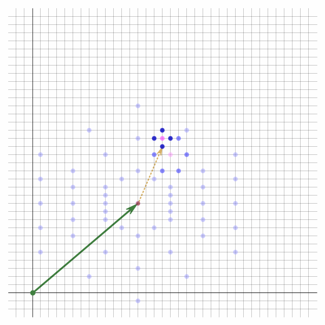

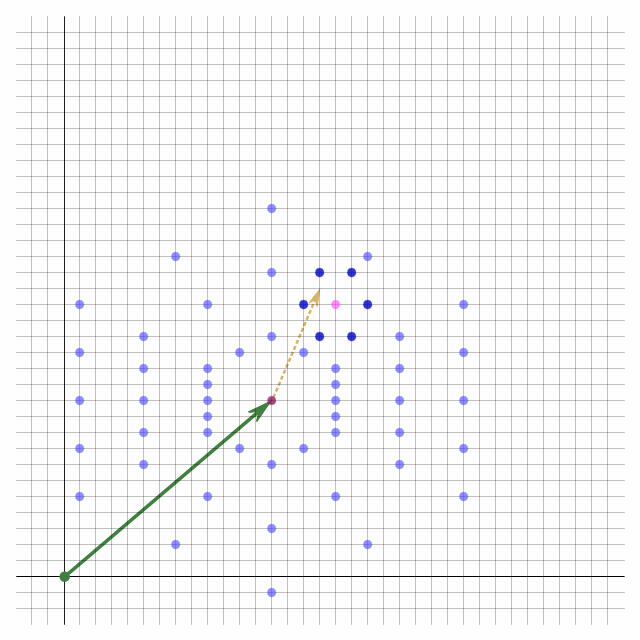

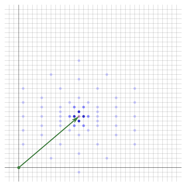

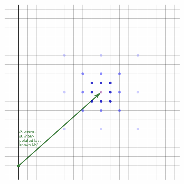

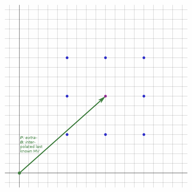

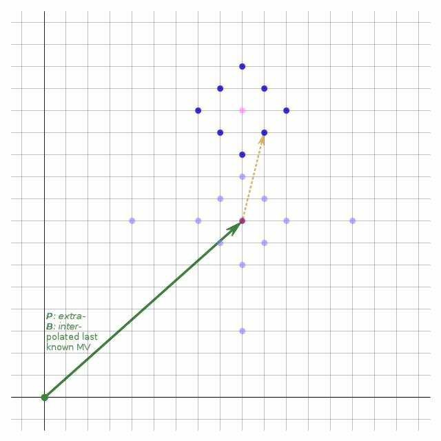

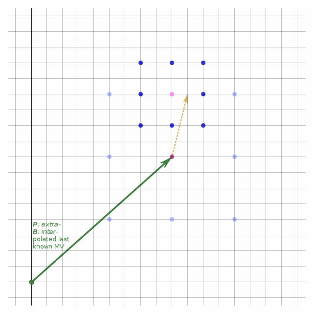

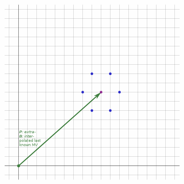

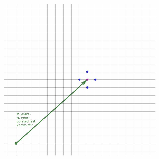

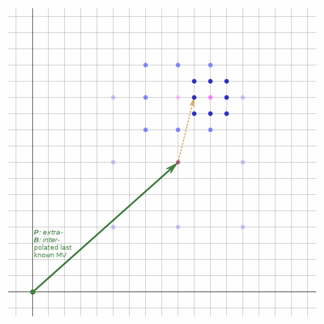

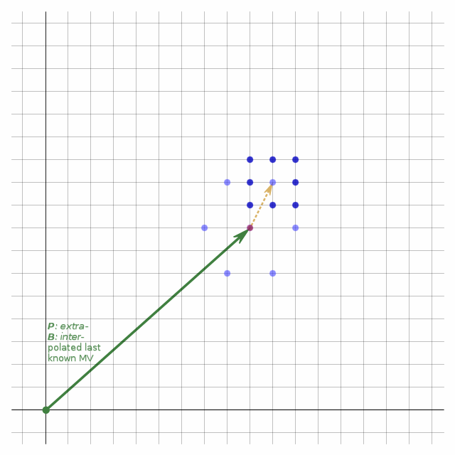

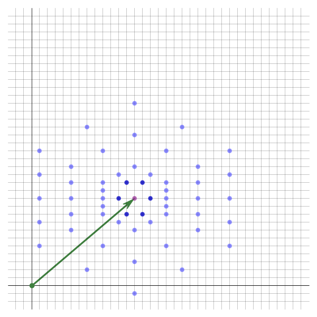

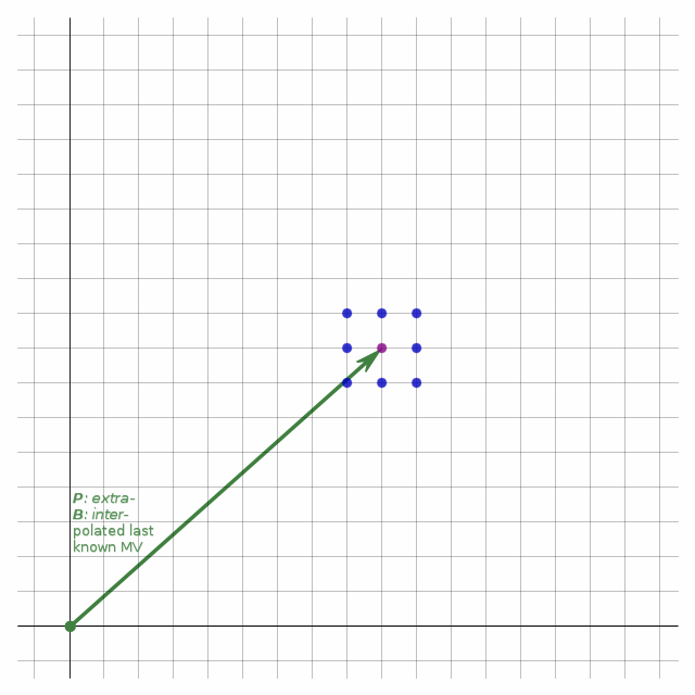

Here are some additional images, based on my limited understanding of different sources (^#3, papers, slides...) of motion search algorithms, some e.g. used in x264 and x265 as well; no guarantee for a correct representation, correction remarks are welcome in case of a misunderstanding.
Exhaustive search: a waste of time {complexity should be O(nē) ?}, only for comparison with more efficient algorithms if they are possibly less precise
  • one step: Every pixel distance in a square neighborhood (here displayed with a maximum range of 8Ũ8, will probably often be more)
Diamond search: small direct neighborhood, only suitable for littlest expected motion changes
  • one step: 1 adjacent pixel in each orthogonal direction
Square search: small complete neighborhood, only suitable for littlest expected motion changes
  • one step: 1 adjacent pixel in each direction
Hexagonal search: 2-step search in a slightly larger range, assuming more probable vertical directions
  • step 1: ~2 pixel (approx. Euclidean) distance in 6 directions
  • step 2 – continuous motion, good hit: additional square refinement
  • step 2 – changing motion, offset: additional square refinement
Star-shaped search: Large diamond shape with additional satellite samples in the first step, good for expected mainly orthogonal motion
  • step 1: 2 pixel "Manhattan" distance in 8 directions + 5 pixel distance in orthogonal directions
  • step 2 – continuous motion, good hit: additional "Small Diamond" refinement, 1 pixel orthogonal distance
  • step(s) 2 – changing motion, offset: additional recursive search with "Large Diamond" range, 2 pixel "Manhattan" distance
  • step(s) 3 – changing motion, offset: additional recursive "Small Diamond" refinement, 1 pixel orthogonal distance
Successive Elimination Algorithm (SEA): Logarithmic square search (effectively as good as exhaustive); here with only 3 steps in a reduced 7Ũ7 range {complexity should be O(ld(n)) ?}:
  • step 1: 4 pixel square distance
  • step 2 – continuous motion, good hit: additional 2 pixel square distance refinement
  • step 3 – continuous motion, good hit: additional 1 pixel square distance refinement
  • step 2 – changing motion, offset: additional 2 pixel square distance refinement
  • step 3 – changing motion, offset: additional 1 pixel square distance refinement
Uneven Multi Hexagonal search (UMH): 3-step search in a larger range, purposefully suitable for expected wide and probably random motion, but generally elaborate
  • step 1: ~4+8+12 pixel (approx. Euclidean) distance in 16 directions (vertically more dense)
  • step 2 – continuous motion, good hit: additional hexagonal 2 pixel refinement
  • step 3 – continuous motion, good hit: additional diamond refinement
  • step(s) 2 – changing motion, offset: additional recursive search with hexagonal 2 pixel distance
CC-BY
New German Gleitz board
MediaFire: x264 | x265 | VPx | AOM | Xvid
LigH is offline   Reply With Quote

Originally Posted by LigH View Post
I know. – Still, I believe it's the best place.
Thanks for the explanatory post. So in your understanding, which method gives the highest quality among the last three? Star, SEA or UMH?
aymanalz is offline   Reply With Quote
Old 16th December 2016, 08:43   #20  |  Link
LigH
German doom9/Gleitz SuMo
LigH's Avatar
Location: Germany, rural Altmark
Posts: 7,254
That's the wrong question, IMHO. All three are able to find the optimal motion vector – even if it is rather distant from a previous estimation (due to recursive search steps to continue into the direction of the best match so far). They will merely differ by the required time to find the optimum, but when it's found, the quality will be the same in all cases.
Assumed there are no misleading constellations which provoke the recursive search to fail when led into a wrong direction, in which case the remaining difference to be quantized would be of a bigger magnitude, or an intra coded block would be required, which would take more space and reduce the efficiency.
Star has a smaller scope right away, it will terminate faster for rather regular motion, which may differ a bit more in mostly vertical or horizontal direction. The scope of UMH is wider, there are already 49 samples always in a first step (16 directions * 3 radii + the origin of the estimation), which will make it probably one of the slowest of these three on the average, yet may be more suitable for the case of a rather shaky camera or otherwise randomly changing motion. And SEA is effectively exhaustive over the whole motion range square, its speed would be constantly high, equal to the dual logarithm of the range for 8..9 samples in each refinement step; to beat UMH on average speed, it has to calculate at most 6 steps which would cover a square of +/- 32 pixels around the estimation, if I'm not completely wrong...
For encoding a TV broadcast of a sports event, I would probably trust the star-shaped motion search because motion will most often be quite regular (well estimated), which will save some time in comparison to UMH (probably good for action body camera footage) and SEA (probably best for those who insist in "the best" regardless of costs).
